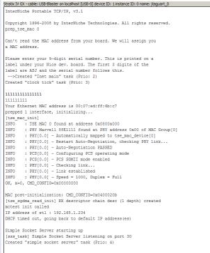

when I run the software this is what I get
https://www.alteraforum.com/forum/attachment.php?attachmentid=12398
Your Ethernet MAC address is 00:07:ed:ff:6b:c7
prepped 1 interface, initializing...
[tse_mac_init]
INFO : TSE MAC 0 found at address 0x0800a000
INFO : PHY Marvell 88E1111 found at PHY address 0x00 of MAC Group[0]
INFO : PHY[0.0] - Automatically mapped to tse_mac_device[0]
INFO : PHY[0.0] - Restart Auto-Negotiation, checking PHY link...
INFO : PHY[0.0] - Auto-Negotiation PASSED
INFO : PCS[0.0] - Configuring PCS operating mode
INFO : PCS[0.0] - PCS SGMII mode disabled
INFO : PHY[0.0] - Checking link...
INFO : PHY[0.0] - Link established
INFO : PHY[0.0] - Speed = 1000, Duplex = Full
OK, x=0, CMD_CONFIG=0x00000000
MAC post-initialization: CMD_CONFIG=0x0400020b
[tse_sgdma_read_init] RX descriptor chain desc (1 depth) created
mctest init called
IP address of et1 : 0.0.0.0
I don't understand why am I getting that IP address,

Hi I have disabled the DHCP from the BSP editor. Then gave a static IP of 192.168.1.234, then I run it and here are the results,
I have noticed that LED D23 keeps blinking and the RX LED of ENET is blinking too but what does that "yyyyyyyyyyy" mean ????!!!
