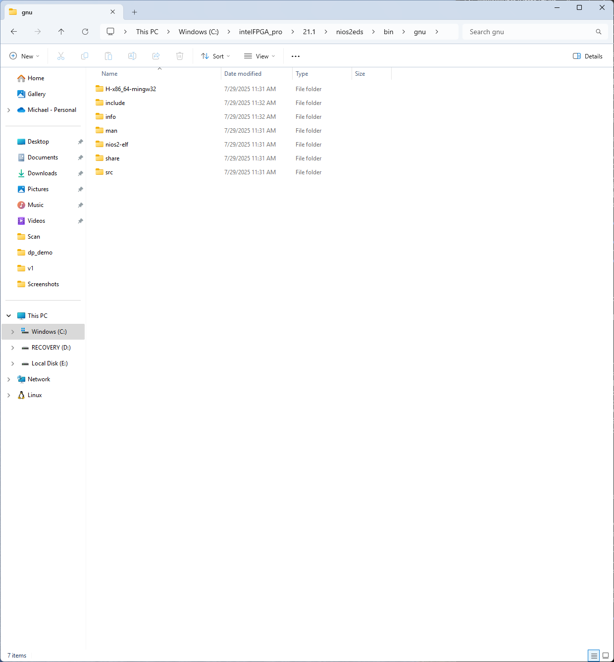

While running build_sw.sh in the nios2 command shell, the following error occurred:
make: nios2-elf-gcc.exe: No such file or directory.
I've attached three screenshots of this issue.
Please help me resolve this issue.
Michael
The actual directory contains "H-x86_64-mingw32", but the path only contains "H-i686-pc-linux-gnu".
Is this error related to this issue?
