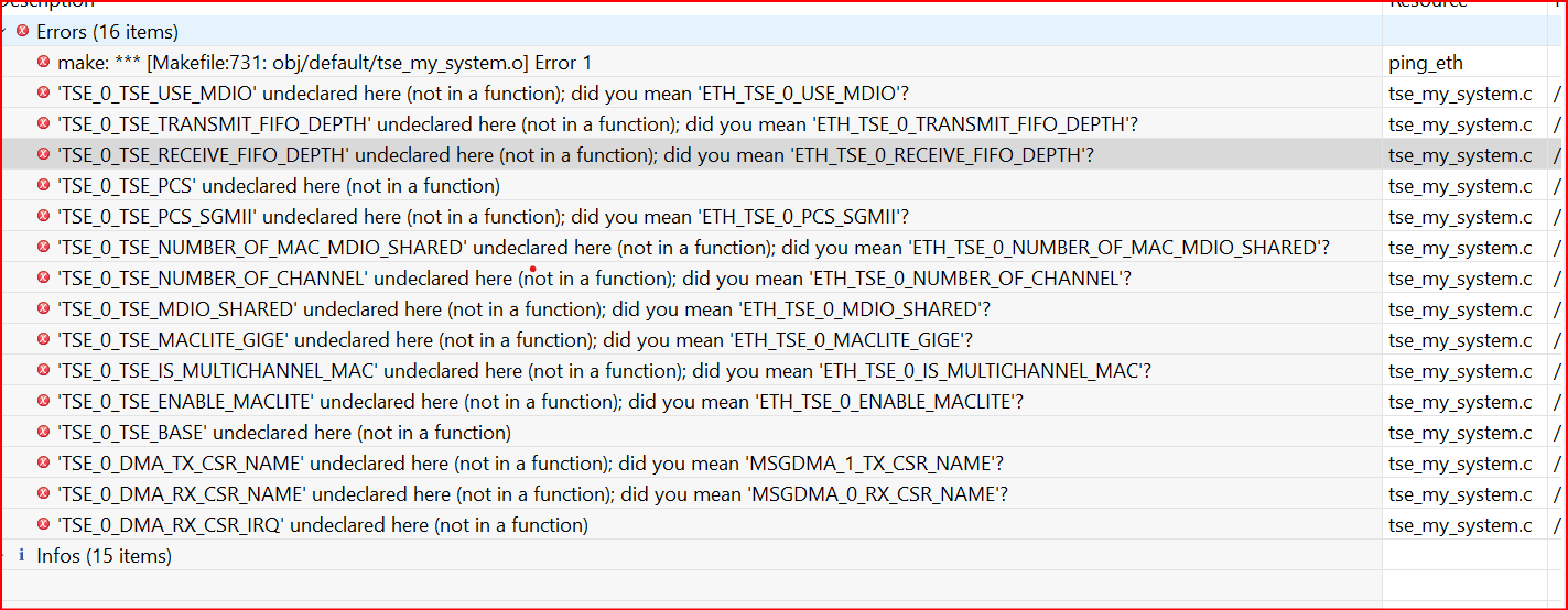

Hi ,
i am working with cyclone 10gx FPGA series, I was trying to create a ethernet MII interface with Nios ii eclipse .i was trying to build one simple socket ping  project in Niosii eclipse i am unable to generate .elf in any ethernet simple socket example generation getting errors as shown below .
could you please provide any one have solution resolve the issue ,if any one have faced and resolved.
B. Sateesh

Hi
I believe we had a call previously arrange by your FAE regarding this issue.
This problem is due to the generated file format was changed in newer Quartus versio.
Could you try to change the line that you are facing error to the line below(line 39, tse_my_system.c) :
TSE_SYSTEM_INT_MEM_NO_SHARED_FIFO(ETH_TSE_0, 0, MSGDMA_1_TX, MSGDMA_0_RX, TSE_PHY_AUTO_ADDRESS, ADDITIONAL_PHY_CFG)
I managed to get it to compile successfully but meet an error in the elf size.

Hi Venkata Sateesh
you could try increasing the on chip memory ip size to accommodate the nios application size.

Hi Sateesh
Could you try adding the memory to at least 500KB?
Please make sure that you are increasing the size of the onchip_memory2_0.
You will need to regenerate the project and generate the BSP again before compiling.

sateesh999
2,382 Views
hi Jingyang,
Hi tried the given solution now able the generate the .elf ,but it not running on the hard  for ping condition, could we connect one small section to address the issue any thing do we to add modification in code as per my phy chip ADIN1200CCP32Z. to make it for simple socket ping purpose

Hi
With the TSE Soft IP, the supported phy includes the following only
National DP83848C (10/100 Mbps)
National DP83865 (10/100/1000 Mbps)
Marvell 88E1111 (10/100/1000 Mbps)
Marvell 88E1145 (Quad PHY, 10/100/1000 Mbps).
However you could add in your own PHY Definition using the API "alt_tse_phy_add_profile()"
https://www.intel.com/content/www/us/en/docs/programmable/683402/22-4-21-1-0/phy-definition.html

Hi
You could find the registers for the values in the datasheet below:
https://my.mouser.com/datasheet/2/609/ADIN1200-3121141.pdf
After going through the datasheet it seems like the registers are not in the standard format below:
   * Table below show the format of the return value required by TSE driver PHY detection
   * | BIT | Value: Description                           |
   * | 31-17 | Reserved                                |
   * |  16 | 1: Error:Invalid speed read from PHY                  |
   * | 15- 4 | Reserved                                |
   * |  3 | 1: 10 Mbps link                            |
   * |  2 | 1: 100 Mbps link                            |
   * |  1 | 1: 1000 Mbps link                           |
   * |  0 | 1: Full Duplex          0: Half Duplex            |
You are required to create your own function to return the speed and and duplex mode.
You can see how it is for the National DP83848C PHY.
The OUI, model and rev from the ADN1200 datasheet is 0x0283, 0x2 and 0x1
