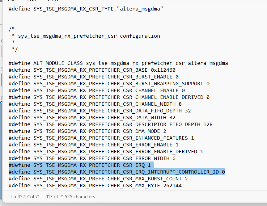

Hi
For the interrupt number and controller it is defined in the system.h file.
In the system.h under the interested IP the define for the interrupt number and controller number is defined there.
E.g. the interruptcontroller number and the number for the mSGDMA is define below.
Instead of hardcoding it, you could use the define int he system.h
Whenever you regenerate the BSP the system.h will be updated.

Thank you for the reply.
Did you read the earlier messages?
We are talking about the "Interrupt Request" from a custom HDL module added to the Platform Designer. In earlier versions of Quartus, we could use the "Associated addressable interface" parameter to connect the custom "interrupt sender" to an interface and create a relevant parameter in "system.h," but it seems that this feature has been removed.
The solution that you mentioned only works with the "Intel IP Cores", and we are already familiar with this.
