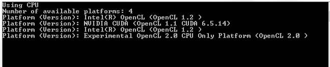

INDE API trace was working wonderfully for a few days and suddenly stopped returning any trace information. I started investigating and noticed that, when enabled, another Intel OpenCL platform shows up at runtime when I query all available platforms. Using this newly created OpenCL platform, again that only shows up when API trace is enabled, allows me to get the trace results that I was looking for. Why it worked two days ago without any adjustments to my code is still a mystery to me.
But I'm happily tracing again, I'm just curious if this nuance is expected and documented somewhere?

Code builder reports these platforms:
Which is what my application shows when API trace is disabled:
But when I enabled API tracing via CODE-BUILDER->OCL Debugger->Options my application shows:
If I configure my application to grab the first platform listed as Intel(R) OpenCL, API tracing does not work. If it uses the second it does. I shared a memory leak application with Robert for another issue that shows this behavior as well.
