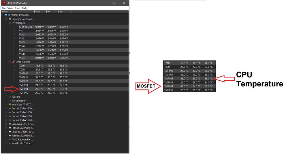

KrissyG
New Contributor II
9,551 Views
@KirinCooper wrote:
I suspect that the cause may be the motherboard then, in bios I have PL1 and PL2 set to 253, however the motherboard is the (MSI) H610M-B, although I'm not sure whether that can be resolved in bios, the cooling solution says Air tower cooler (PL1:100W) although my PL1 is set to 253W, so I think that may be it, but I'm not sure because the CPU exceeds 100W and as such I am unsure as to how to resolve the issue
(MSI) H610M-B? does it look like this?
The one i found has no MOSFET heatsink, not even one, i highly doubt that without any heatsink thee MOSFETs can take even 100W for a longer period of time.

If the MOSFETs would overheat, a thermal throttling would take place. Since i have no idea where you could look it up, i will suggest installing Hardware Monitor, run some stress test or benchmark and watch the temperatures that it shows.
The highest temperature usually is the CPU, second highest will be the MOSFETs.
You should not be seeing any values close to +100°C on the MOSFETs.....in fact, none of the shown values should reach that temperature even after few minutes, else thermal throttling will take place.
In my caseTMPIN4 are the MOSFETs, for you it may be one of the other values.
