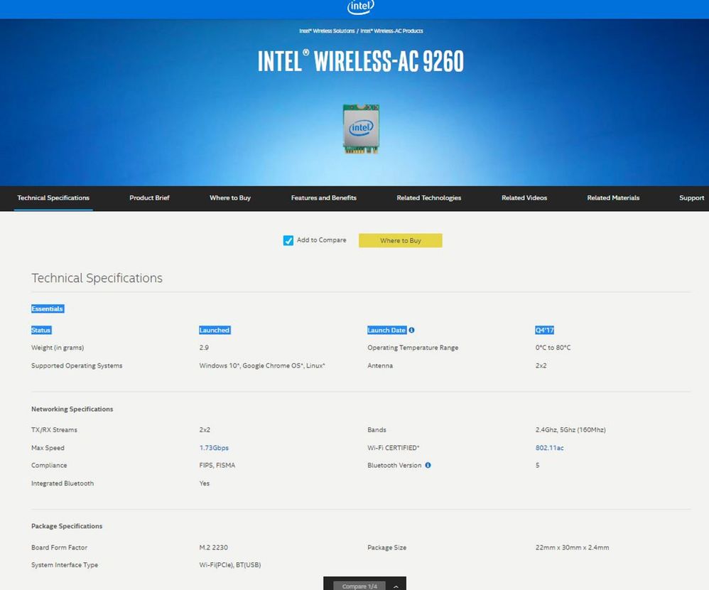

At a product page at https://www.intel.com/content/www/us/en/products/wireless/wireless-products/dual-band-wireless-ac-9260.html Intel offers the following technical specifications for the 9260:
(I can't seem to get this a legible size.)
Under Package Specifications it lists Board Form Factor as M.2 2230 and System Interface Type as WiFi(PCie), BT(USB)

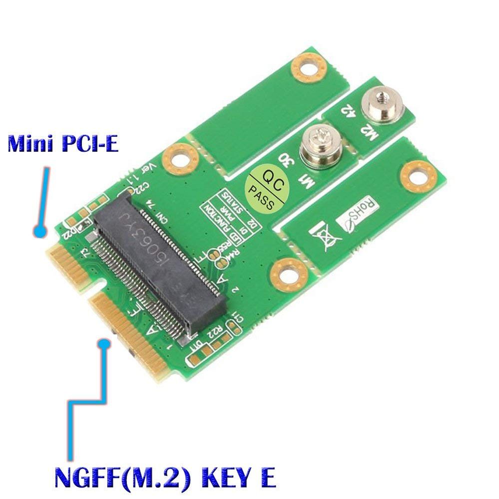

"I figured it out with some research. The answer is no. The M2 slot on the B250 pro-VD board is M keyed. The wireless card is A keyed so it will not fit. It look like this adapter will be able to make it work though. https://www.amazon.com/gp/product/B017OZQDQ8/ref=oh_aui_detailpage_o00_s00?ie=UTF8&psc=1"

Did you take a look at the adapter at https://www.amazon.com/gp/product/B017OZQDQ8/ ? This gizmo looks as though it might do the trick. The PCB looks like it has various tabs that can be broken off to make sure it fits the screw pattern. It is unclear if the conjoined boards keep the headroom low enough to close the laptop case. What is most confusing is the customer review that mentions different keys from E. One of the reviews is about a desktop.

First of all, regardless of anything else, you absolutely cannot use the Intel Wireless-AC 9560 module (see its product brief here: https://www.intel.com/content/www/us/en/wireless-products/dual-band-wireless-ac-9560-brief.html). This module has a CNVio interface and thus cannot be used with older platforms (boards and processors) that do not support this interface.
Now, as for the Intel Wireless-AC 9260 (product brief here: https://www.intel.com/content/www/us/en/wireless-products/dual-band-wireless-ac-9260-brief.html), I am skeptical that the adapter will allow this module to be utilized, but I cannot absolutely rule it out. The mini-PCIe (Gen 1, M.1) interface exposes a single PCIe lane. The M.2 Type A and M.2 Type E interfaces that this card is normally plugged into both expose two PCIe lanes. If the 9260 module works with a single PCIe lane, there is the possibility of this working. If it requires two PCIe lanes, however, it isn't going to work. As well, these cards expect PCIe 3.0 support while your laptop only has PCIe 2.0 support. I cannot tell if backwards compatibility is being provided. I rather doubt it, considering that the M.2 standard requires PCIe 3.0.
A secondary consideration is whether the height of the adapter plus Wireless card is beyond what the laptop chassis makes available.
One other thing I can say for sure is that the antenna leads in your laptop are not going to be compatible with the 9260 card. You will have to do some finagling to use it with this laptop regardless of anything else

I noticed that the 9260 has two keys labelled "A" and "E"; the adapter has only "E". I surmise that A and E refer to a topology with two physical "planes" of etching on the PCB, which support the electronic "lanes". I further surmise that it is these two lanes that give rise to the adapter being able to handle multiple 160 Mbyte channels of 11ac, thus parallel processing attaining Gigabyte throughput. This would be behind the mPCIe 3.0 version number.
As the shim-like adapter gizmo has a key only for "E", I would think this is what indicates that it has only one lane and supports only mPCIe 2.0. (Or 1.1?) And you can't get blood out of a turnip.
Does this sound right? I think it's enough to justify a no-go decision. Alas, I have apparently been grasping at straws while pushing the river.
