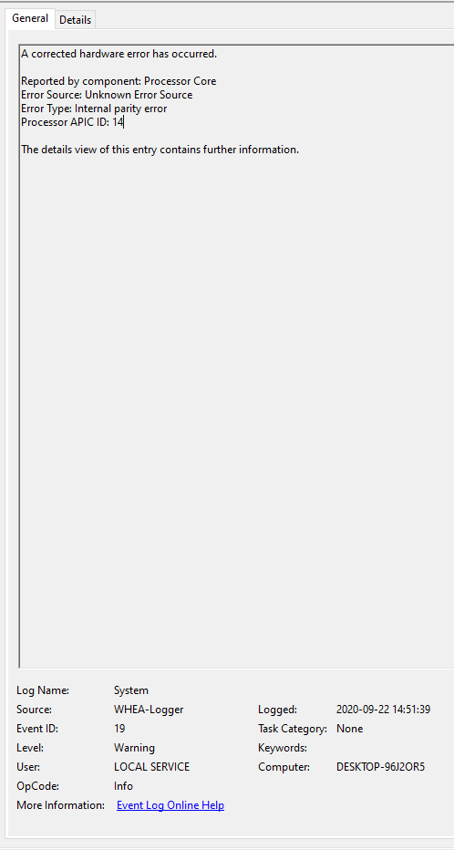

When I was talking in Skype (audio) and I did not use my computer to anything else I did go away during the talk and then when I did end the call on my computer it did freeze for about 2-5 sec and then it started to work again. I did take a look in the event viewer and I did find a WHEA error. It did not BSOD so I did not get any DMP file.
What's hard to tell is that the Error Source is unknown but it still state that the CPU did report it.
Is this because of the CPU or not? This WHEA has only happened once and no more. The Computer is 2 months old.
Should I be worried for this one WHEA error? Should I RMA the CPU or should I just wait and see if I get any other strange issues?

Troubleshooting that I have done:
Memtest64 - 4passes no issues
OCCT small and big data for 2 hours no issues
Prime95 for 2h blended mode no issues
intel diagnostic tool can't find any issues
Done after the WHEA to make sure it don't happens again.
Reset BIOS with CMOS
Re-Install Windows 10 2004
Overclocked: No, has never been actually I did modify the BIOS setting to get Intel defaults P1 125w P2 250w and time 56 seconds. I also disabled Enhanced Turbo.
What I did find after I did reset CMOS was that I did miss something called cooling and it was set on Water cooling P1 4025w but as I did modify the P1 and P2 manually I'm sure that it don't effected anything as I did run test and the CPU did not go over stock speed but it might effect the vcore I don't know anyway I have change it to stock cooler P1 125w now.
I have attached all of the WHEA errors info from the Event View in a RAR file to this post also I have run the Intel System information software so I have all of the info for my System in the System.txt file that I have attached to this post.
But here is a screenshot of the error:

The WHEA error seems to be an indication that a parity error was detected, likely in data arriving from memory. It could be in the processor cores, processor uncore or in graphics subsystem. This was a single-bit error, which is recoverable (can be reconstituted). If it had been a multi-bit error, it would have been more catastrophic.
Neither of these other reports had anything to do with this WHEA error. They occurred days apart from the WHEA error.
Should you be concerned? Yes. Is it the processor's fault? Likely. If it reoccurs, I would RMA the processor.

It is possible that this is a DRAM issue (noise on a memory bus could cause a parity error), but it is unclear (at least to me) that this will result in a WHEA error being exposed like this. Regardless, it might just be a glitch and you never see it again. If that's the case, no worries.

It did happen again, exact same messages. It did happen during night when computer was idling. It seem that it happens when idling.
Only thing that is different it's that the Processor APCID ID is 13 this time but before it was 14.
I guess that I need to RMA this CPU.
n_scott_pearson
13,302 Views
Well, you've got an issue in the processor, chipset (PCH) or memory. I guess it is just as easy to try replacing the processor first.

I have a case with Intel and I have req a advanced RMA because I need the computer in work because of COVID19 and well it's only 1,5 month old.
