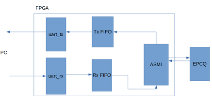

I recently want to use ASMI's IP to update the content of FPGA,
And my architecture is shown in Figure 1
My question is,
After I deleted all the unused FF data after the .rpd file and wrote the EPCQ through ASMI, I could not successfully configure the FPGA after powering on again.
I have compared the data before and after writing, and they are no different.
Are there any suggestions for my approach?
Thanks for your answers.

Hi, thanks for your reply
I have solved my problem.
It’s my own problem, I thought the end message of .rpd was 2b c0(Fig)
But later it was discovered that there were other messages besides FF.
