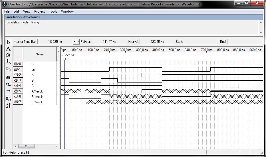

This is a complex problem which I am very unsure of, the basic idea is that I want code that switches between 3 SPIs.
I was startled when I noticed the statement that I was about to write
A_SCLK <= C_SCLK
C_SCLK <= A_SCLK
both are true, but this would induce registers, all I want is a wire connection.
-- The idea is that choose either A or B is exclusively -- connected to C library IEEE; use IEEE.STD_LOGIC_1164.ALL; entity bidir_SPI_switch is port( A_SCLK, B_SCLK, C_SCLK : INOUT STD_LOGIC; A_SOMI, B_SOMI, C_SOMI : INOUT STD_LOGIC; A_SIMO, B_SIMO, C_SIMO : INOUT STD_LOGIC; A_CSn, B_CSn, C_CSn : INOUT STD_LOGIC; en, S : IN BIT ); end bidir_SPI_switch; architecture behaviour of bidir_SPI_switch is process(en,S) begin -- MASTER enable if en = '0' then A_SCLK HOW?? C_SCLK else -- SELECT either A or B end if; end process;

I can't make it happen. Have a look at the attachment for the results.
Basically, it should just be a mechanical switch i.e.
when en = 0, wire A should be connected to wire C.
when en = 1, wire B should be connected to wire C.
-- The idea is that choose either A or B is exclusively -- connected to C library IEEE; use IEEE.STD_LOGIC_1164.ALL; entity bidir_SPI_switch is port( A_SCLK, B_SCLK, C_SCLK : INOUT STD_LOGIC; en, S : IN BIT ); end bidir_SPI_switch; architecture behaviour of bidir_SPI_switch is begin process(en,S) begin -- MASTER enable if en = '0' then A_SCLK <= C_SCLK; B_SCLK <= 'Z'; C_SCLK <= A_SCLK; else -- SELECT either A or B A_SCLK <= 'Z'; C_SCLK <= B_SCLK; B_SCLK <= C_SCLK; end if; end process; end architecture behaviour;

Try this idea...
you better think of signal driving another than connectivity. remember connectivity in HDL does not mean that each side is driving the other.
you will need three choices:
if A master then
A_sclk <= 'Z'; --driven from A chip
B_sclk <= A_sclk;
C_sclk <= A_sclk;
elsif B master then
Altera_Forum
1,545 Views
You can't route a bidirectional signal without an explicite direction information.
I asked about the SPI master and slave roles, because I can hardly imagine a SPI network, where the peers change their role spontaneously. At least, it hasn't anything to do with known SPI standards.
You have similar problems however with true bidirectional lines, e.g. an I2C bus or simply the data lines of a processor bus. If a FPGA is intended to route a signal of this kind, it must be supplied with an additional direction information, or it has to decode the communication protocol and determine the actual data direction from it's protocol knowledge, if possible at all.

This has been unsuccessful, it seems nothing is going through the switch.
Is there an example code out there that shows how to build a Bidirectional bus and the assumptions required of the entities that connect to it.
This is doing me head in.
Altera_Forum
1,545 Views
In my opinion, the problem is a lack of clarity about the required prerequisites of a bidirectional "switch". A FPGA doesn't offer bidirectional bus switches of analog switch type. It can implement bidirectional buffers, similar e.g. to a 74HC245, that however need a control signal to decide about the actual data direction.
You have to find out, how this direction information can be deterrmined.
Altera_Forum
1,545 Views
Thanks FvM, I've added an extra pin in the design for direction and now it works fine in simulation with the bigger design.
