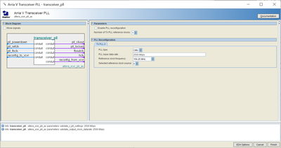

This is my Transceiver PLL component as generated by the IP wizard:
I have doubts about how to connect the following singals:
1. pll_fbclk (input)
2. fboutclk (output)
3. hclk (output)
paveetirrasrie_Intel

host
1,266 Views
That's exactly what I did:
And the PLL is generated as follows:
How should I connect the following ports ?
3. hclk (output)
1,051 Views
After checking on this, here's the connection guideline:
  •  The proper connections are to connect "fboutclk" to "pll_fbclk" and to leave "hclk" open.
Hope I've answered your query.
Regard,
Pavee
