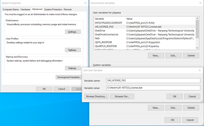

actually, it's  LM_LICENSE_FILE environment variable issue. please follow the below steps to set environment variable.
in windows, START menu => view advanced system settings
system properties will pop up. in this window
Advanced => Environment Variables
Environment Variables window will pop up
in that widow, under the User variables for "user_neme" click on new.
there give LM_LICENSE_FILE in Variable name option. next, click on browse the file and select your license file.
after completing these steps open the cmd window and try to execute the example project.
i attached my complete steps screenshots and cmd terminal log file. please follow these steps and update the status of the issue.

Hi Hareesh,
I have 2 generated licenses. It seems like one is for Quartus Prime Pro and the other one is for Quartus Prime Pro and Questa.
LR-118484 - Questa*-Intel® FPGA Starter Edition SW-QUESTA, Intel® Quartus® Prime Software SW-ONE-QUARTUS
LR-107533 - Intel® Quartus® Prime Software SW-ONE-QUARTUS
When I tried using LR-107533.dat, I get the following result:
When I use LR-118484, I get the following result:
Is there something that I am doing wrong?
I have added the debug files for your reference.
Thanks.

hareesh
2,178 Views
it's environment variable issue only. please follow bellow steps. after that also if you facing an issue please tell me your free time. I will arrange a call to guide you.
