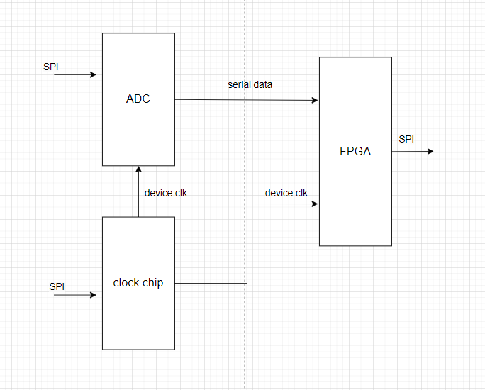

    My device version is stratix10 1SX110HN2F43I2VG. I use FPGA to receive JESD204B data from ADC chip. When I power up the PCB, both the FPGA and ADC do not have device clock input, or the input is at a lower erroneous frequency.Then I configure the clock chip through SPI so that both the ADC and FPGA receive the correct device clock. However, the ADC still does not output JESD204B data. Then, I configure the ADC through SPI to output JESD204B data. I found that the rx_islockedtodata signal is 0. I tried disconnecting the xcvr_reset_control IP core, manually resetting rx_analogreset and rx_digitalreset, but still could not make rx_islockedtodata high. After reconnecting the xcvr_reset_control IP core and reloading the sof file, rx_islockedtodata successfully becomes 0xF. This means that even though the FPGA has received the 204B data  rx_islockedtodata remains at 0. After reloading the sof file again, rx_islockedtodata becomes 0xF. How can I bring the rx_islockedtodata signal high without reloading the sof file? Or what variables during the process of reloading the sof file cause the rx_islockedtodata signal to go high? Does the FPGA only program sof file when ensuring JESD204B data input?

Yes the root cause is same as you mentioned - no ref clock when FPGA is configured (First time).
Can you please share the reason for configuring LMK04832 via SPI for every power cycle?
Can you program the LMK04832 once and it'll retain the clock configuration? -> If yes Do it.

I noticed the reset sequence in the datasheet, which states that before programming the FPGA, stable OSC_CLK_1, management clock, and transceiver reference clock (device clk) are required. However, for my current design, after powering up the board, only OSC_CLK_1 and the management clock are stable. The device clk comes from the clock chip, which needs to be generated through FPGA configuration after I finish configuring the FPGA. I attempted to program the FPGA for the first time and then use the FPGA to configure the clock chip via SPI. At this point, I have stable OSC_CLK_1, management clock, and transceiver reference clock (device clk). Then, I program the FPGA again and configure the ADC via FPGA using SPI to output JESD204B data. rx_islockedtodata can become F, and data reception works properly. Can I achieve JESD204B data reception with only one FPGA programming? Could ADM experts or technical support give some advice? thanks.mmexport1711939720104.png

    I am using quartus Pro 22.3 , clock chip is LMK04832 , according to my latest findings, before configuring the FPGA, the transceiver must has a stable reference clock. before loading the .sof file for the first time, the clock chip was not configured, leaving the transceiver without a reference clock. After loading the .sof file, the FPGA automatically configured the clock chip, then the clock chip consistently provided stable output. Therefore, by the time I load the .sof file for the second time, the transceiver already had a stable reference clock, and rx_islockedtodata change to high.I'm not entirely sure if this is the root cause of the issue

I attempted to manually control rx_analogreset and rx_digitalreset of the jesd204b IP core through ISSP,  affter LMK04832 is configured , but it didn't work. It seems that configuring LMK04832 before FPGA is the only solution.

  Thank you. We didn't notice this when designing the clock scheme for the project initially. It should be more reasonable to configure the clock chip in another way. The changes will be implemented in the next version of the PCB.

You need to provide stable reference clocks of jesd204b ip core before the start of FPGA configuration, I am currently using a microcontroller to configure the clock chip. After the configuration is complete, load the sof file to the FPGA, the jesd204b IP core can work properly.
