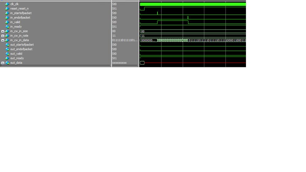

I use LDPC IP Core for 802.11n decoder in Quartus Prime Pro 19.1, however , when I give some input data and control signals there is no output?  ​I find when reset_reset_n signal turn to high level ,the output disapears.

​Hi,
My Quartus version is Quartus Prime Pro Edition 19.1, FPGA device is Arria 10   10AS066H3F34I2SG. I use LDPC IP which configuration as follows.
Then I follow you steps to generate example design for simulation. However, there is still no output , the simulation screenshot as follows.
My ModelSim version is INTEL FPGA STARTER EDITION 10.6d. Then I use my own instance of the LDPC IP, the simulation as follows.
I think it might be short of some .hex files which save the adjoint matrix for 802.11n decode. How do you think?

Thanks for highlighting this. This seems weird. I have managed to replicate similar observation as yours when I tested with S10 LDPC in Q19.4Pro. I have tested with WiMedia 1.5 mode and seems to observe output = 0 as well. I have file a case to Factory to seek further clarification.

Sorry for the delay. For your information, as per my discussion with Factory, currently they are having bandwidth limitation to perform further investigation into this legacy IP. Sorry for the inconvenience.
As a workround, I have tested running the IP generated in Quartus Standard Edition and observe that the simulation seems to be working. However, in the Standard Edition, there is no 802.11n standard.
