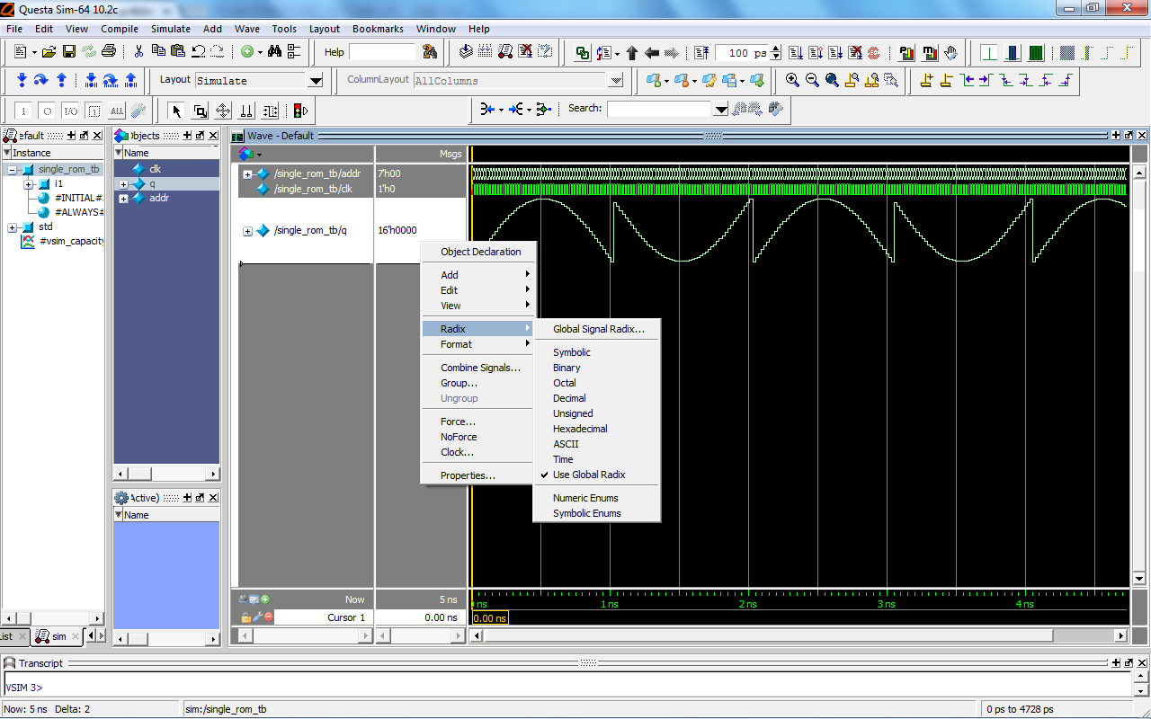

Hi! I have the same project.I want to create sin-signal for tests, but it's an error when I put negative numbers into .mif file. Insted of negative numbers Questa show me zeros.
How Can I solve this problem?
Main code:
module single_rom ( addr, clk, q ); //input input addr ; input clk; output signed q; //ip-cores rom_ip rom_ip_component ( .address (addr), .clock (clk), .q (q)); endmodule
Testbench:
`timescale 1 ps/ 1 ps module single_rom_tb(); // test vector input registers reg addr; reg clk; // wires wire signed q; // assign statements (if any) single_rom i1 ( // port map - connection between master ports and signals/registers .addr(addr), .clk(clk), .q(q) ); //clk initial begin clk = 0; forever# 10 clk = ~clk; end //beginning address initial addr = 7'h00; //loop always begin @(posedge clk) if (addr >= 7'h64) addr = 7'h0; else addr = addr + 7'h1; end endmodule
Contents of .mif file:
WIDTH=16; DEPTH=110; ADDRESS_RADIX=UNS; DATA_RADIX=DEC; CONTENT BEGIN 0 : 0; 1 : 5; 2 : 15; 3 : 80; 4 : 345; 5 : 656; 6 : -1; 7 : -2; 8 : -3; 9 : -4; 10 : -5; 11 : -6; 12 : 20886; 13 : 22430; 14 : 23885; 15 : 25247; 16 : 26508; 17 : 27665; 18 : 28713; 19 : 29648; 20 : 30465; etc
Picture, you can see zeros instead of negative numbers:
http://s7.hostingkartinok.com/uploads/thumbs/2014/11/03327b0a1b3e6e4dc3e1dd541e47935d.png (http://hostingkartinok.com/show-image.php?id=03327b0a1b3e6e4dc3e1dd541e47935d)

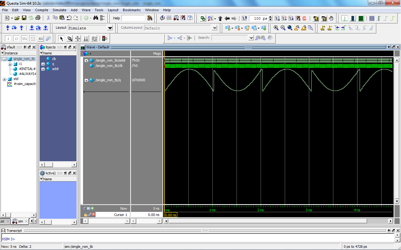

Thank's for your answer, but I did it and I got the following picture it Questa.
I can't submit it like a signed number. In radix I use decimal, but it also ansigned.
How can i transform it into unsigned?
http://s7.hostingkartinok.com/uploads/images/2014/11/504de2f5c58eae37f09eb5c10191f761.png (http://hostingkartinok.com/show-image.php?id=504de2f5c58eae37f09eb5c10191f761)

You are displaying the wave form as hexadecimal. Change the draw type to "signed". Right click -> radix -> signed

I also try -radix signal q signed.

The wave screenshot posted above already shows a different problem than what you have reported initially. The negative values are not replaced with zeros anymore, rather you seem to be missing the sign bit this time. You need to inspect the values shown in the diagram to be able to tell what's happening - for example, what is the value at the peak of the sinusoid? For 16bit signed integer, your values in the LUT/MIF should be in the [-32768;+32767] interval, are they?
Altera_Forum
40,534 Views
--- Quote Start ---
I did it, but it didn't fix my problem.
--- Quote End ---
your mif file is set to unsigned radix but the data ia signed so keep it signed and change radix in mif file to signed
