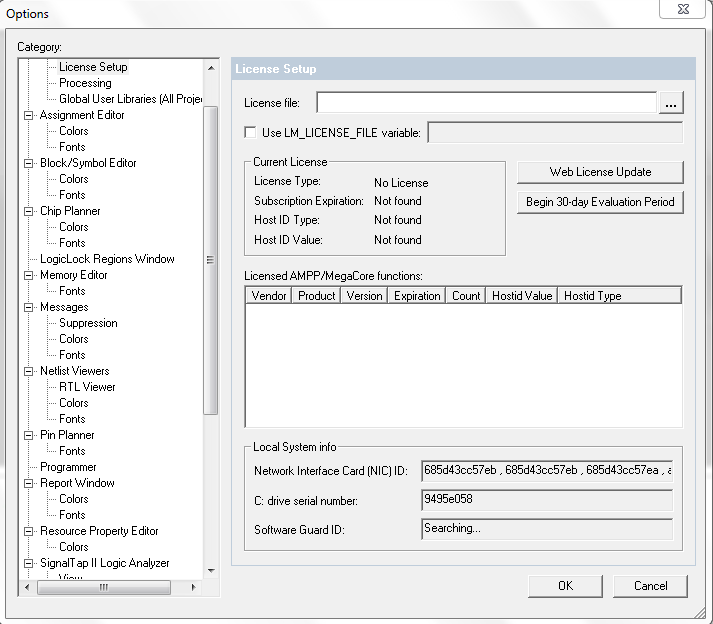

Quartus II that came with my Cyclone II starter development kit asks for license after new/recent intallation.
Hi, I have had the cyclone II fpga starter kit (Eval board) from Altera for more than 10 years. It used to work with no license issues in the past. Now that I recently installed it on my new laptop (still has Windows 7 like the older laptop), it asks to set up a license. I think in the past it was done automatically in the background, but probably since Altera website/link is different it asks for a license now (either *.dat file) or web set up.
As stated I have already paid for the SW/tools as part of the entire Dev kit in the past, and it worked for a few years, but giving me issues in the new install. It is Quartas II version 7.2
It also comes and works with the Modelsim-Altera 6.1g. I'm hoping a solution you provide will make both work again like the past several years. They are already paid for as part of the FPGA Eval kit. Thank you!

Hi
Welcome to INTEL forum. Based on my understanding, the DevKit license only valid only for 1 year and Devkit license is not renewable.
Alternatively, you could apply an Intel Web License use with Quartus
Here’s the steps:
1.          Login to https://licensing.intel.com/
2.          Go to Sign up for Evaluation or Free licenses
3.          Select Intel® Quartus® II Software SW-QUARTUS-WE-FIX
4.          # of Seats is always 1 for Quartus Web Edition
5.          Check the T&C box
6.          Click Get License button
a.          Check the option product “Intel FPGA Software SII-NONVOLENCRYP”
b.          Add New Computer or Assign an Existing computer
7.          Add the required fields
8.          Click Generate License
You will be taken to the Licensing page, and you should be able to receive the email with license attached.
