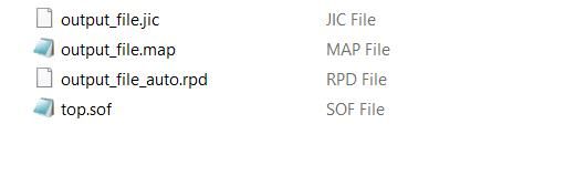

JingyangTeh_Altera
3,272 Views
Hi Rajesh
So sorry that you could not see the attached file.
Let me reattach it here.
It is a zip file case.zip and the content of the zip are as follows:
Jingyang, Teh
