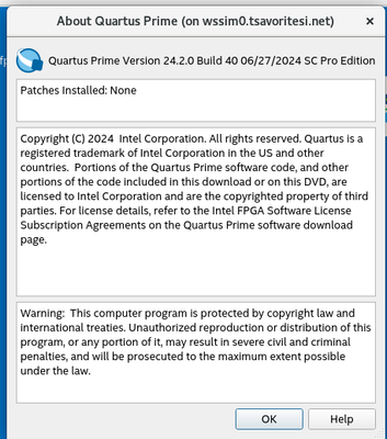

awaissman
1,148 Views
Hi Aik,
I have 24.2 quartus version.
aikeu
1,114 Views
Hi awaissman,
Your version used is a Pro or Standard version?
Thanks.
Aik Eu
awaissman
1,088 Views
Hi Aik,
This is Pro Edition.
