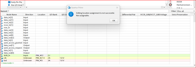

Hi Intel team,
       issues we are getting continuing  from previous post is we are trying to do flashing through sfl loader when ever we are trying to assign pins we are getting below error .could anyone have faced and resolved let us known to move forward.

flash should be connected according to device manual scheme, either ASx1 or ASx4 (Figure 122 respectively 123). Your above pin list is at least missing DATA -> AS_DATA1 connection for ASx1.
Device will be usually programmed through JTAG indirect programming from .jic file which has to be generated in programming file converter tool. Alternatively, dedicated AS programming interface can be implemented on PCA according to manual figure 127.
Regarding your latest post, AS pins are dedicated and don't need to be assigned in pin planner.
