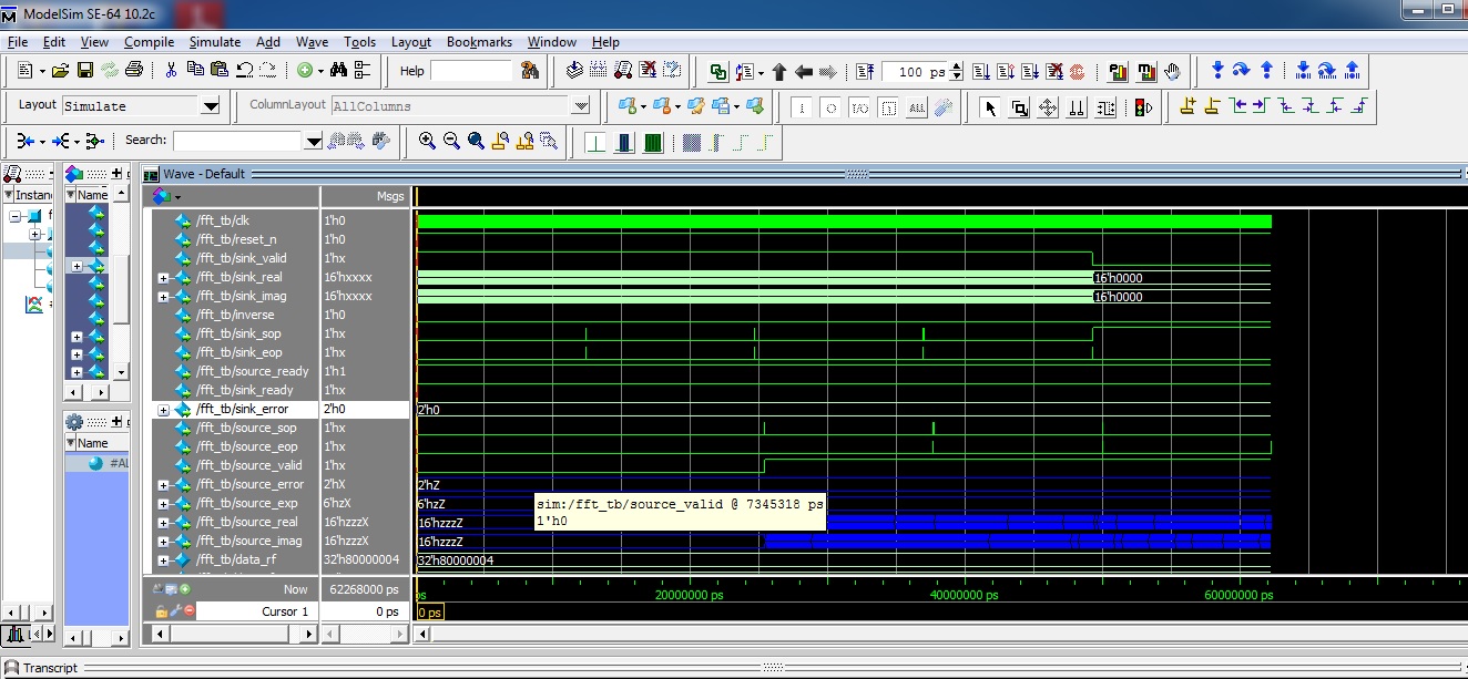

Hello to all.
i want simulate the fft megacore with modelsim.
I use the fft_tb.v generated from megacore.
the output alwas stay at fixed value (see picture).
i do not understand....
Now the simulation works in RTL mode only.
In gate level not working.
The outputs are always at HIz.
I attach the modelsim projects. just edit the runme.tcl with correct quartus path.

Is it SIMU_GATE or SIMU_RTL you are simulating?
SIMU_GATE produces output with Quartus 14.0 + Modelsim 10.1e

TNX James.
I attach my simulation of SIMU_GATE with modelsim 64bit 10.2c.
have you only launched the runme.tcl in the modelsim software, or have you used qartusII 14 for compilation?

I ran your script in modelsim. I shall attach a picture of the output in a mo. Ahh sorry it was the RTL I simulated, which worked fine. So it is the gate level that fails? Sorry misread your initial post.
Altera_Forum
1,088 Views
I get the same result as the last pic you posted (running script only). Only bottom bit of the output active all others tri-state :-(. Very odd!

Yes.. rtl simulation have outputs ok..
gate simulation have output high impedance :(
Altera_Forum
1,088 Views
OK now i resolved the problem.
I assigned incorrectly the size bus in my top level module.
Now gate simulation works fine.
TNX!!!!!!!!!!!!!!!
