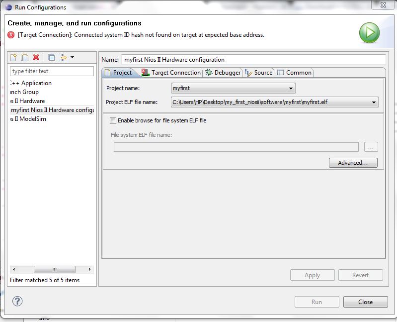

click the "target connections" folder. Look if the usb blaster appears in the connections list. If don't, click refresh connections one or two times. It should appear, so you can click run button. Don't forget to check the download firmware option.
thank you :)
