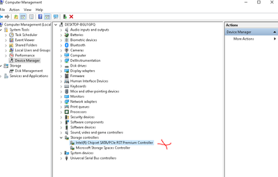

Hope you can assist me . I am having a issue where RST is removing my SATA SSD . Rebooting sometime resolves the issue.
I have tried the following : Looked for RST and BIOS updates through Dell support assistant and on the Intel website. No new drivers available.
Looking for a permanent resolution.
Thanks in advance !

Hi Jose
· Was it working before? ---> Yes
· Did the issue start after an update? ----> Looks like it as I have Dell Support Assistant installed on my Dell laptop, it checks for driver updates etc.. I have also installed Intel driver update checker , and to auto check for updates on the Intel site. No new updates found.
· Have you reinstalled the Intel Rapid Storage Technology Driver? -----> I have tried to manually install this from Intel website but it did not want to install : The Intel® Rapid Storage Technology (Intel® RST) Floppy Driver (17.11.0.1000) supports the configuration and enabling of system acceleration with Intel® Optane™ memory and maintenance of RAID 0/1/5/10.

Hi Jose
Thanks for the feedback .
I downloaded Intel ME and got his message when I tried to install. I did not continue with the install.
I tried downloading the Dell RST driver and installing it now. Got the following error.

Also tried by updating it via this method , by specifying the directory where the newly downloaded RST is , but get message that latest drivers are installed.
