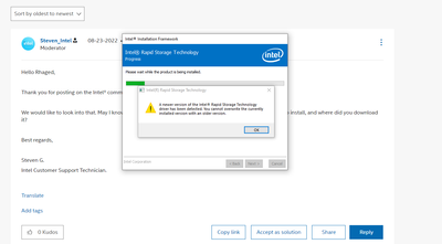

I recently noticed when booting on my raid screen the status of the raid is rebuild. I have had this before on a older computer and I did was run RST and rebuild it. But on this computer I don't seem to have RST. So tried installing it said it found a new driver installed. Which I'm gonna assume is Intel(R) Chipset SATA/PCIe RST Premium Controller.
I have tried removing it, and installing without rebooting and the setup fails right away. And if I remove and reboot it comes back on its own.
Logs below

We would like to look into that. May I know what version of Intel® Rapid Storage Technology did you attempt to install, and where did you download it?
Steven G.
Version 18.6.1.1016
And to add to which error this is the message.
And for the current driver

In order to continue working on this, please download the Intel® SSU https://downloadcenter.intel.com/download/25293/Intel-System-Support-Utility-for-Windows-
Open the application and select "Everything", click on "Scan" to see the system and device information. By default, Intel® SSU will take you to the "Summary View". Click on the menu where it says "Summary" to change to "Detailed View". To save your scan, click on "Next", then "Save". Please attach the file to your reply.
