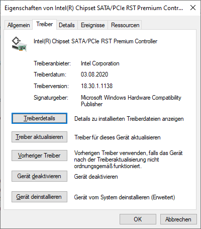

Hello Deivid,
thank you for your reply. I'm using the following version of IRST:
Trying to install any other IRST version over this version, the downloaded IRST installer claims that I'm "already using the latest or even a newer version. […] Aborting installation."

Hello HolyKnight,
Thanks for the picture sent. Can you add a picture of the Intel® Rapid Storage Technology (Intel® RST) version from the Intel® RST Tool as well?

I just re-installed Windows 10x64 Enterprise 22H2 and re-installed IRST.
So, now here is the screenshot you requested:
In regard to the drivers, I guess you are looking for something like this:
My mainboard is an Asus X99-E WS.
