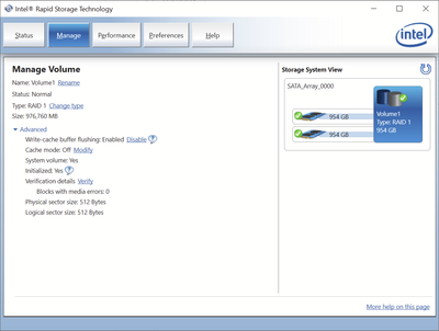

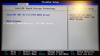

This system is a Raid1 bootable Windows 10 operating system. Attached is a shot of the bios indicating Intel RST being used, and also a windows shot of RST in use running with the existing raid1 1TB SSDs.
No third party systems have been added to the system.
I dont think the system is operating at SATA , as the RST System Report (attached) is indicating: "Port interface: NVMe", whereas the SATA_Array_0000 is just a name, this could be called eg Volume.

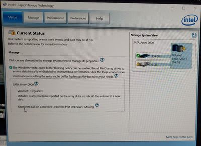

After replacing one of the SSDs with the new 4TB M2 then following the boot i went straight to the RST program and it indicated that below:

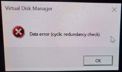

 Indicating the 0TB for the new SSD. I then came out of the RST program and started Windows 'Disk Management' and it indicated that the drive was not initialised and then offered the option to initialise. I did this and got the Date Error (cyclic redundancy check)

Following the above i used a USB M2 caddy to initialise successfully both new 4TB SSDs using the Windows Disk Management. That was only initialising  and no formating, and there was no indication of any failing to the SSDs.

Perhaps one reason for that is because the BIOS ROM RST Raid Driver has version: 15.2.0.2754, and the Windows RST has version  has version: 16.7.1.1012? Perhaps these both need to be the same version, or just that the ROM 15.2.0.2754 Raid Driver just cant handle a 4TB drive, or a Gen 4 drive. (The new 4TB SSD is Gen4, whereas the older 1 TB SSD is Gen3 - however manufacturer indicates they should be 'backwards compatible').
