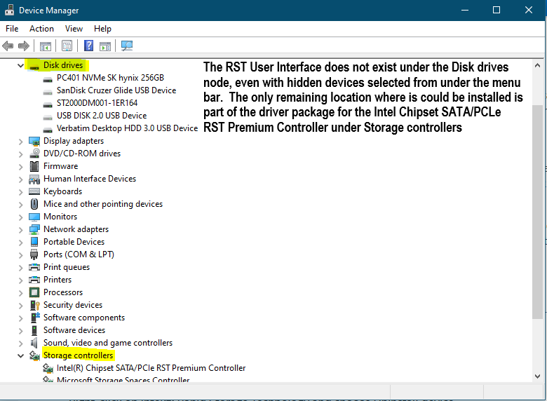

The unknown answers to the following questions have prevented the task of installing the applications:
1.) Is the (SetupRST.exe) to be installed as step #1 for setup of the advanced features of RAID management using the Optane Memory and Storage Mgmt app ?
2.) Is the f6flpy-x64.zip standalone installed after the SetupRST.exe is installed? The ReadMe file appears to indicate this is to be installed before installing the Optane Memory and Storage Management app from the Microsoft Store.
3.) Should a search for an RST update from my OEM 's site be performed during any steps?
4.) When is the un-installation of the Non-Driver Components performed in Programs and Features in Control Panel ? According to Section 10 of the ReadMe.txt , this step un-installs Intel RST 17.7.0.1006
A basic step by step guidance on installing/un-installing the files would be appreciated.

If I uninstalled the RST app in Apps and Features, wouldn't the driver from Device Manager under Storage Controllers which is shown as the Intel Chipset SATA/PCLe RST Premium Controller and that also has the same version (17.7.0.1006), be uninstalled also since they appear to be no different as far as these driver versions?
No, when you uninstall the RST app from Apps and Features you are only uninstalling the console, that will not uninstall the driver.

We have a generic version of the driver 17.7.0.1006, however, the Intel* generic driver cannot be installed through the Windows* updates, if the version of Intel RST currently running on your computer was installed through Windows Updates, it means that this version was provided by your computer vendor since these drivers are usually distributed through Windows Updates.
It is important to note that in order to use the new Intel Optane Memory and Storage Management application from the Microsoft Store*, Intel Rapid Storage Technology Driver Version: 17.9.1.1009 (generic) or higher is required. (You can check for the specific one with the OEM)
Trying to install the Intel Optane Memory and Storage Management application from the Microsoft Store* while using an older version will not allow the driver to communicate correctly with the new application. For this reason, we recommend that you do not try to install it unless the new driver (.1009) supporting this user interface is installed on the system.
Regarding the uninstallation of the user interface, you can go to Apps and Features and uninstall the user interface manually. After that, you can go to Device Manager and uninstall the driver if available. We recommend first uninstalling the previous driver to avoid any conflict between the drivers.
  • Press Windows X keys
  • Select Device Manager
  • Find and expand the Disk drives catalog
  • Right-click on Intel Rapid Storage Technology and choose Uninstall device.
Keep in mind that as you don't have any RAID volume (according to the report) in your system there is no need to have the app or driver installed.

Your reply included instructions on how to remove the RST User Interface. The issue is that the RST Management utility doesn’t exist in either Apps and Features under windows settings or in Device Manager under Disk Drives. (attached screen shots).
1. Can you suggest another way to remove the User Interface?
2. Would the system report showing 0 volumes for the internal SATA drive have to do with the presumption that a software RAID setup doesn’t show volumes in the report? I also don't know if the fact that the RST utility has been outdated for some time now and reached EOL factors into the equation.

As I mentioned, you need the app or interface to monitor and make changes on your volumes, so there is no only hardware, it is software and hardware RAID controller, the support of the configurations will depend on the OEM specifications.
The name of the App that you have to uninstall is "Rapid Storage Technology" from Apps & Features. If you don't have a RAID volume you can uninstall the App/Software, we recommend you to leave the Driver that is the " Intel Chipset SATA/PCIe RST Premium Controller", this because the chipset will need the driver, the Native Command Queuing (NCQ) is working properly, this is an extension of the Serial ATA protocol allowing hard disk drives to internally optimize the order in which received read and write commands are executed. You can uninstall the app but the storage controller will remain on the Device Manager, this is now part of the OS since the first time you install it, now, if you want to delete it, you should have to reinstall the Operating System.
Can you please provide us with more details about your second question? Yes, according to the report you don't have any RAID volume configured on the system, even though you have an outdated version, if the RAID volume was set properly it should be shown on the RST report. Did you set a RAID volume (RAID 1, 0)?
Every time you change SATA controller from RAID to AHCI in the BIOS or the software you will have to reinstall the OS because the machine will think that this is a hardware change. This is how the Intel* RST works.
Keep in mind that you are using the DELL* System, and they may provide you with more specific steps and information for your specific unit, I checked both manuals available and I didn't find information about how to set up a RAID Volume or BIOS setting for this. So, the best will be to contact Dell* they can confirm BIOS settings and how to make the proper changes.
