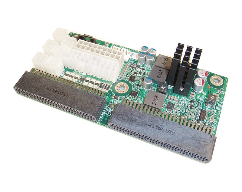

I'm having great trouble finding details and part numbers on the intel site for any extra cables for this chassis.
The first and most important would be the number for a cable that plugs into the chassis power board.
As I mentioned there's 5 empty sockets in the power board that are 2x2
Calling a provider results in them asking for part numbers that I don't know.
The power board itself has 2 numbers I've found - one on the board itself - DAOS6CTB4DO
and the other while googling that number - R4208P4MHGC
I can't find these numbers searching the intel site - I'd like to find some documentation on the specifications of the board.
Though I can find the board sold on amazon and ebay
The part itself looks like this: https://i.ebayimg.com/images/g/HMIAAOSwWnFV76nZ/s-l1600.jpg https://i.ebayimg.com/images/g/HMIAAOSwWnFV76nZ/s-l1600.jpg
As you can see, it has 5 sockets on the left that are 2x2 - they are all empty in my chassis.
Is there somewhere that lists the power board or the cables on intel? I can't find them using the intel site search.
Hi, Canno,
In regard to your question how to connect the Gigabyte* GeForce GTX 1070 to the Intel® Server Chassis P4304XXMUXX.
The available spare cables for the Intel® Server Chassis P4304XXMUXX do not match your requirements; however, the power board has standard 2x2 12v Molex connectors. It is possible to get them from any pc retailer.
I am sending you the http://download.intel.com/support/motherboards/server/s2600cw/sb/s2600cw_p4000g_configuration_guide_rev1_42.pdf Configuration guide and spare and accessories guide for the Intel® Server Chassis P4304XXMUXX
I have attached a possible example from Newegg.
https://www.newegg.com/Product/Product.aspx?Item=9SIA5B554X4745&cm_re=cable_4_pin_molex_to_8_pin_pci-_-9SIA5B554X4745-_-Product Athena Power Dual 4-pin Molex to Dual 8-pin 6+2 PCI-Express Cable Cable-PCIE4628

Thanks - yes that manual has all the part numbers I've been looking for.
Much appreciated.
