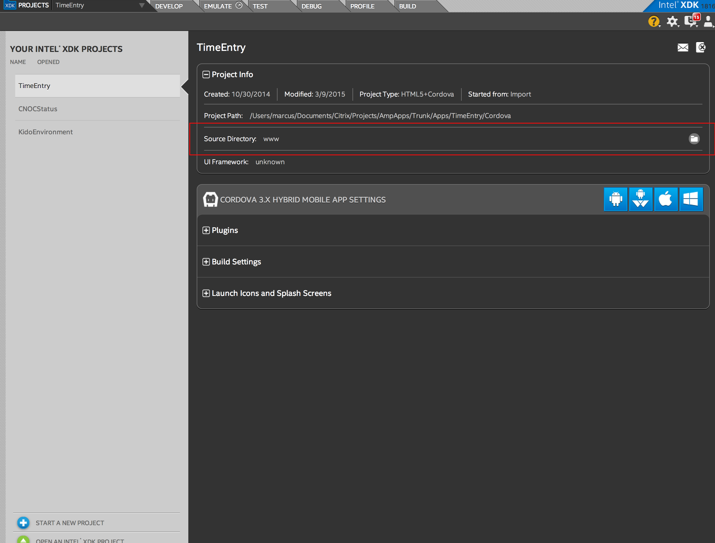

I uninstalled and reinstalled XDK. I can now switch between projects, but if I switch source directories for a project I have to quit and reopen XDK for the app to work in the Emulator. Attached is a screen grab of the error ('XDK can't find your app') I get. And yes, the index.html file does exist.

Marc_S_
2,621 Views
In the settings page. See attached.

Are you saying that your project directory contains multiple "source directories" -- each with a unique index.html file? If that is what you are doing, that will confuse the XDK. It is not designed to work with such a situation. If it worked in the past it was pure luck. The "source directory" in the project settings is there so you can customize the location of your index.html file so you don't have to use the default value of "www" but it is not there to change as part of using your project.
Can you provide a detailed step-by-step describing what you are doing to create this issue?

During the development phase of project this is not really an issue. But when we move to QA, this becomes a pain point. I make a change in the app directory, test, create a release build, then change the source directory to www to confirm the change and build the app. I understand this is not a typical workflow for Cordova apps, but I prefer to minify and optimize my apps before packaging them. So having two working directories is a necessity.

Hi Marc, thanks for the video, I'm filing a bug report. It looks like this is related to some other issues I've encountered where properties on the Projects tab are not getting saved out properly and are impacting other parts of the XDK. What you are attempting to do is perfectly reasonable and should work.

I have diagnosed your problem, and it is indeed a bug in the XDK.
To emulate a Cordova project, the source must be "prepared".  This step combines your project sources with the sources for the selected plugins and produces what is essential a copy of your project, specialized as appropriate. This copy only includes project source files below the source directory for your project.
The bug is that the "prepare" step always uses the same value for the source directory, even if you change it in the project settings.  That's why the emulator can't find your index.html file after you changed the source directory. The emulator is looking for the correct file, but it didn't get included in the copy because the "prepare" was done with the wrong source directory value.
You can work around the bug by changing projects (and then changing back) after each time you change the project source directory.  I appreciate that this is inconvenient, but this is the best we can do until the bug is fixed.
