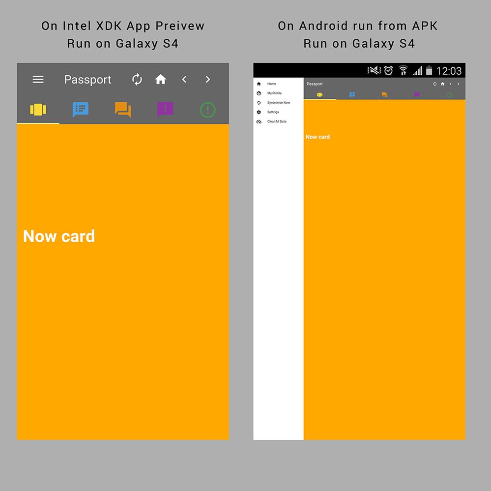

ISSUE 1
I had a great joy testing my app on XDK app preview. It was running fine and looking as expected on Intel App Preview.
However, when I compiled it into .APK file, it appeared very different to the app preview.
Am I doing anything wrong when building .APK file? The look on App Preview is correct one.

The reason your app looks different is because the app preview you are using to test with is based off the Cordova builds. The legacy builds are not based off of Cordova. They are legacy and will soon be removed all together.
I can not access the link of your build log, please upload a txt file of the log for us to look at.

   [crunch] Crunched 5 PNG files to update cache
-package-resources:
     [aapt] Creating full resource package...
     [aapt]     (skipping file '.editorconfig' due to ANDROID_AAPT_IGNORE pattern '.*')
     [aapt]     (skipping file '.jshintrc' due to ANDROID_AAPT_IGNORE pattern '.*')
     [aapt]       Unable to add '.../TravelAppMob/platforms/android/assets/www/components/bower_components/web-animations-js/web-animations.min.js.gz': file already in archive (try '-u'?)
     [aapt] ERROR: unable to process assets while packaging '.../TravelAppMob/platforms/android/ant-build/CordovaApp.ap_'
     [aapt] ERROR: packaging of '.../TravelAppMob/platforms/android/ant-build/CordovaApp.ap_' failed
BUILD FAILED
/Developer/android-sdk-linux/tools/ant/build.xml:928: The following error occurred while executing this line:
/Developer/android-sdk-linux/tools/ant/build.xml:946: null returned: 1
Total time: 9 seconds
.../TravelAppMob/platforms/android/cordova/node_modules/q/q.js:126
                    throw e;
Error code 1 for command: ant with args: release,-f,.../TravelAppMob/platforms/android/build.xml,-Dout.dir=ant-build,-Dgen.absolute.dir=ant-gen
Command finished with error code 8: .../TravelAppMob/platforms/android/cordova/build --release
Error: .../TravelAppMob/platforms/android/cordova/build: Command failed with exit code 8
    at ChildProcess.whenDone (/Developer/cordova/4.1.2/node_modules/cordova/node_modules/cordova-lib/src/cordova/superspawn.js:135:23)
    at ChildProcess.EventEmitter.emit (events.js:98:17)
    at maybeClose (child_process.js:743:16)
    at Process.ChildProcess._handle.onexit (child_process.js:810:5)
Ganesh_B_
938 Views
Hello There,
I've fixed the error now.
As per the above message, I deleted a zip file, 'web-animations.min.js.gz', inside bower_components. And it all started compiling fine. And the look and feel is also as expected.
Thanks.
Ganesh
John_H_Intel2
938 Views
Glad to see you got it working :)
