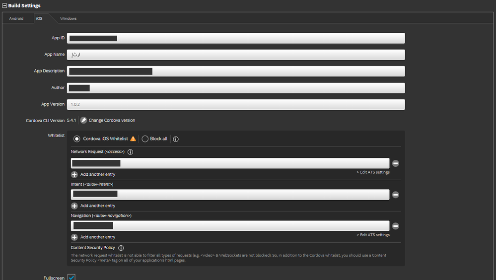

I want to name my app in Arabic but, when i build for iOS, it fails.
Using: Intel XDK 3088
App name: إثرا
Error:
xcodebuild: error: The project 'إثرا.xcodeproj' does not contain a target named 'إثرا'.

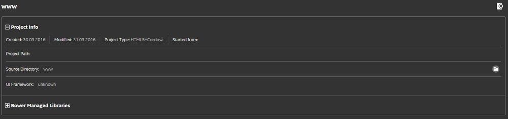

The project was made from scratch in the last build of Intel XDk. Only the App ID has arabic characters, all the folders, files and paths have standard char names.

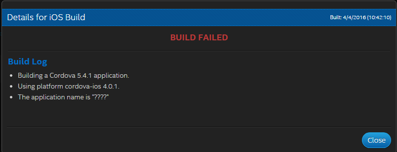

@CI -- can you provide the complete build log following a failed build. We need this in order to get more details about what is going wrong. The build engineer provided this feedback:
I did a successful iOS build with the provided Arabic string. I did find out that the build log does not print out the Arabic name properly.
One of the quirks of the cordova-ios build can cause an error. If the XDK project name and application name are the same but different cases, an error can occur.
We will need the entire compile log to see if we can determine why the build failed.
Expand the "Attach Files to Post" link below the edit window to post the contents of the detailed build log to this thread.

EDIT: I have followed this tutorial (the part with Change the "GUID" to all zeroes) and name the project as the AppName but i get this error :
App project name:  "إثرا"
App Name:  "إثرا"
(no quotes)
With another name , i get this one:
App project:  "إثرا"
App Name:"non arabic app name"
(no quotes)

Unfortunately, the bug is not fixed. I have updated to 3240 this morning, and tried again to build using an arabic AppName. Building with an non arabic app name worked.
I will attach the failed build log.
