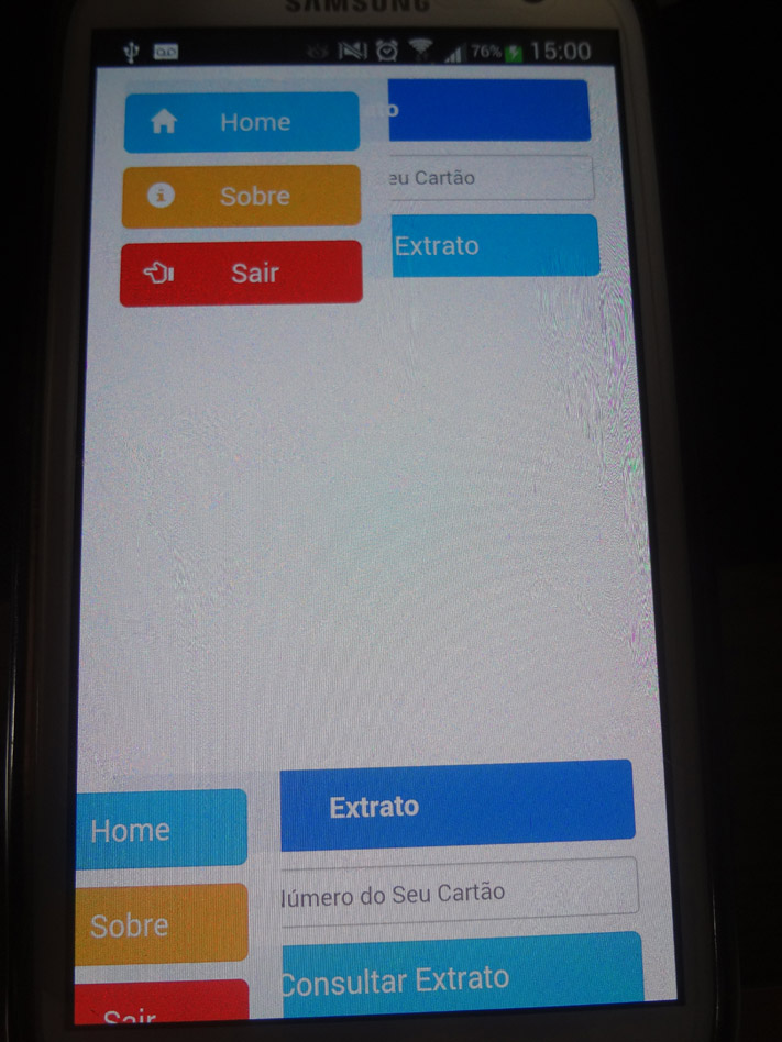

Hi Paul,
Take a look at the image I am sending from my apks... I have built using crosswalk, and I got an apk with 19MB !!! It is surreal !!!
I installed in my Samsung S3 and I resolved my listview problem, but all my design became messed up. The subpages mixes their layouts when I navigate from or to, images do not disappear in the screen after navigation, my footer buttons disappears, although I can use it if I click in the space where the menu should stay.
I am sending a couple of images to show you the problem now.
So, I think this croswalk build option is a worst way to solve my problem.
Marcelo
The larger size APK is due to the fact that there is an alternate webview embedded with your APK. This is far better than the inconsistent and deficient webviews that are resident in so many Android devices. Try running your app on some other Android devices and you'll see what I mean. Once you see that you'll agree that Crosswalk is the better path. See these articles for some explanation as to why you should use Crosswalk: http://blogs.intel.com/evangelists/2014/09/02/html5-web-app-webview-app/ and https://software.intel.com/en-us/xdk/docs/why-use-crosswalk-for-android-...
There have been some rendering issues with Crosswalk 11, which is probably the version you're using. Try setting the Crosswalk version field on the Projects tab to 7 and see how things work with that (when you use the Debug tab).
