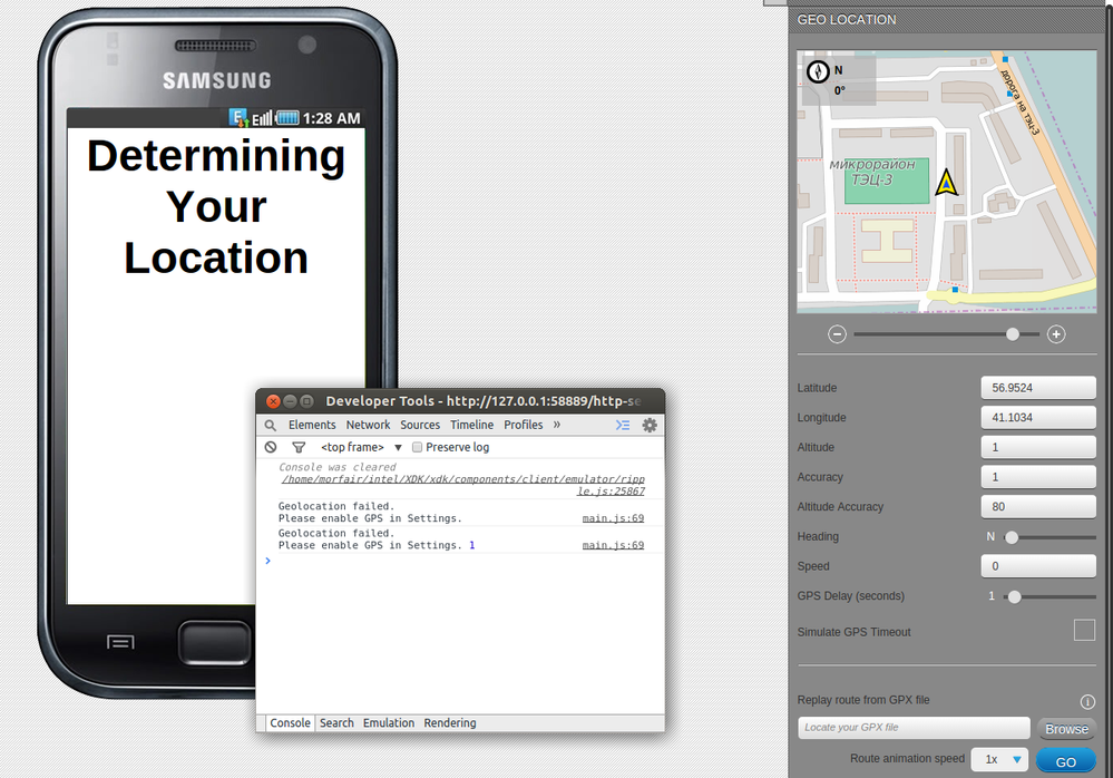

I tried to change intel.xdk.geolocation.getCurrentPosition to navigator.geolocation.getCurrentPosition and Intel XDK Emulator GeoLocation not work more:
PositionError {message: "Timeout expired", code: 3, PERMISSION_DENIED: 1, POSITION_UNAVAILABLE: 2, TIMEOUT: 3}
Can I fix this?

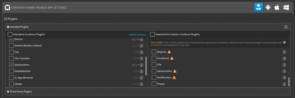

Did you update which plugins you are using in the project settings? You can do so under the Projects tab in the xdk.
Михаил_К_
2,678 Views
I open Plugins section in Projects tab. Standart Cordova Plugins - Geolocation 0.3.11 selected.Снимок экрана от 2015-06-03 10:32:50.png

See the demo that we provide on geolocation. Start a new project, Samples and Demos, HTML5 + Cordova, Geolocation.
Михаил_К_
2,678 Views
I tried and got the same:
Снимок экрана от 2015-06-03 17:28:05.png
John_H_Intel2
2,678 Views
Works for me :) Are you connected to the internet?
Does it work on device for you?
Could your firewall be blocking the XDK from connecting to the internet?

try to run app on the actual device instead of in the emulator. i can get the location once deploy to actual device.
PaulF_IntelCorp
2,678 Views
The Emulate tab and the geo API is kind of tricky if you set it to use an Android device. It is easier to play with if you tell the Emulate tab to use an iOS device. It has to do with the way the Emulate tab interprets the geo JS files for Android. It will work better on a real device.
