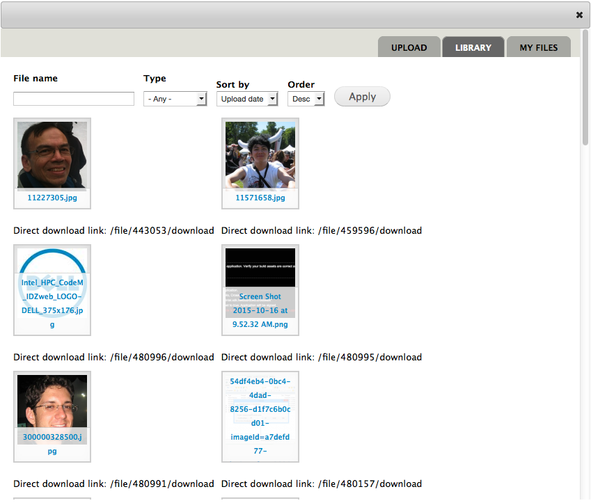

I have create a Showcase for my App. I have downloaded my App Icon and i see it in your Library. Please remove it from your Library.
/file/480691/download and /file/480689/download

p.s. I don't understand what you mean by:
please clarify.

The other means the App Showcase.
https://software.intel.com/en-us/node/add/project
On the bottom is a Browse Link. When you click them, you see a Library. My App App Icon is in the Library and all people see there.
Library path:
PaulF_IntelCorp

Regarding the icon file, I don't see those files you are referencing. If you are looking in the "My Library" tab of the dialog that view is unique to you. Which tab are you looking under? Here's what my view for each of those tabs looks like:

You can see my Icons in the Library Tab. The Name ist icon-72-2x.png.
