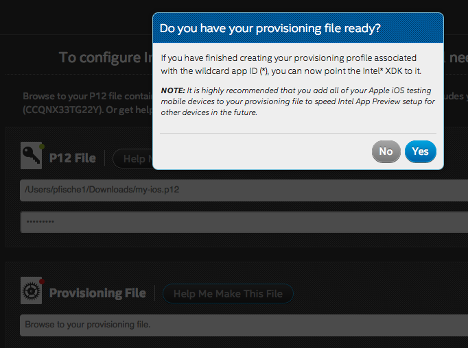

Do you have an Apple Developer account? You'll need that, otherwise you won't be able to generate the necessary credentials.

I'm no expert on that process, it is a very confusing process, but that process looks to me like it should generate what you need to create your debuggable App Preview. In essence, you need to get a "development" certificate that matches your account sent to the build system so it can resign App Preview for installation on your test device. It is important that you create a development certificate and that the provisioning file be a simple wildcard for the App ID (*), otherwise it won't work.

  • Now you need to provide a mobile provisioning file, which you must get from your Apple Developer Account. The instructions for that can be found here: http://www.html5dev-software.intel.com/amdocs/lib/Intel_Walkthrough_CreateDevProvProfile.pdf
  • VERY IMPORTANT! Be sure to set the App ID in the mobile provisioning file you create to '*' so that it will work with any App ID and make sure you created a Development certificate. Because the App ID inside of App Preview does not match any of the App IDs that you may be using for your applications, you must use a wildcard. In other words, the mobile provisioning file you create for this purpose needs to work with App Preview, so setting it to a single wildcard value of '*' (without the quotes) accomplishes that.
  • Download the mobile provisioning file you created by following the instructions in the link above and answer "Yes" to the dialog that is asking if you have your mobile provisioning file (after you've downloaded that file from your Apple Dev Account):
