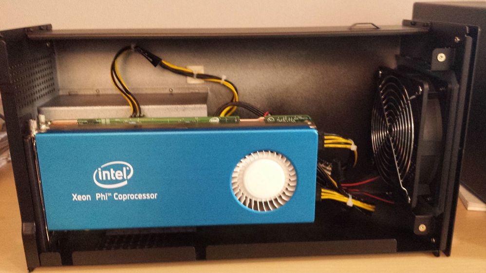

I currently  have two SC7120s.  One is actively cooled (SC7120A), whereas the second one is passively cooled (SC7120P).  The SC7120A is the one I am currently trying to get up and running.  The SC7120P requires a fan shroud that I am currently waiting to be manufactured.  It will allow me to install this into a workstation with adequate ventilation.   Here are some pics of the fan shroud:
Here is a picture of the SC7120A installed inside the Akitio Node chassis.  Sorry for the grainy picture.  I usually have the office lights dimmed:
Eventually, I would like to move to a larger chassis that has 3 PCIe slots so that I can house both the cards, plus an Altera Stratix FPGA board.  But this is all secondary until I can get the laptop BIOS modified for "Above 4GB Decoding"...
