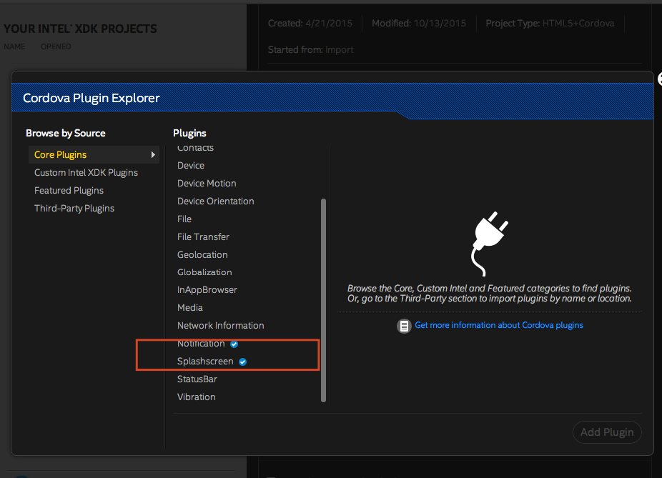

Alexander_F_
5,159 Views
Well I uninstalled all the plugins and installed again and the problem with intelxdk was fixed,
but now I get an error with others plugin installed like is shown in the attached image.
Alexander_F_
5,159 Views
Another error, is impossible something is wrong when try to build the app for IOS and Android with the core plugins,and I do not understand exactly what is happens, please help ASAP, see attached.

Hi John, thank you by your answer but let me tell you that I never include plugins manually, because as you can see in the image all the plugins are included by your GUI and my additions file only contain this.

Alexander_F_
5,159 Views
I will try creating a new app but then I have to add all the screen and logo again is correct?
See attached to know what plugins I need
