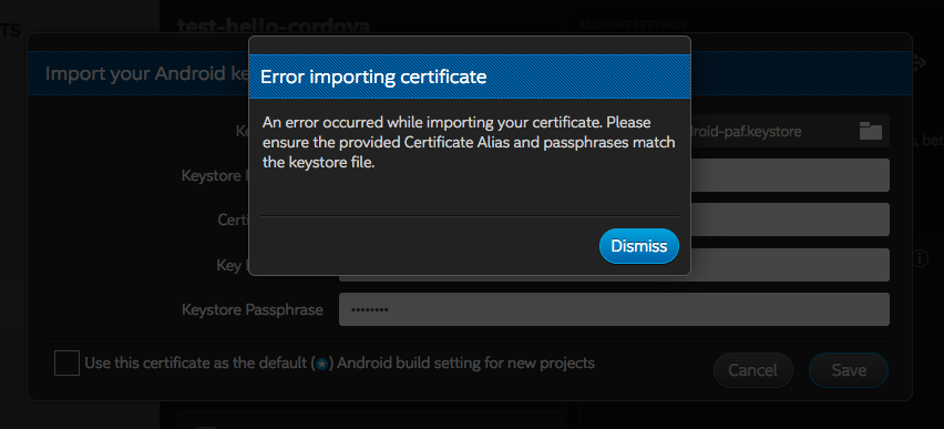

As of June 2, 2017 the ability to create and import Android keystores and iOS signing certificates have been disabled; however, the ability to convert "legacy" certificates and download existing certificates will continue to work.

Error importing certificate: "An error occurred while importing your certificate."
The note about ensuring your alias and passphrase match is misleading. The reason you are seeing this error is because the import service on the backend has been disabled.

The creation and import of keystores has been retired in the XDK. Only existing users with existing keystores can build with the XDK. The build system is scheduled to be retired at the end of June. Please see the release notes for additional information > https://software.intel.com/en-us/xdk/docs/release-notes-information-intel-xdk <

If you have a pre-existing key you can download it directly from within the Intel XDK. Since you can no longer create new keys, this only applies if you have a key that was generated before this feature was retired.
If you need to create a keystore for use with Cordova CLI or PhoneGap Build, see this > http://docs.phonegap.com/phonegap-build/signing/android/#generating-a-private-key < and about halfway down this article > https://software.intel.com/en-us/xdk/docs/build-xdk-app-with-phonegap-cordova-cli < are instructions showing how to download an existing keystore from your Intel XDK account (assuming you have a certificate already present in your account).
