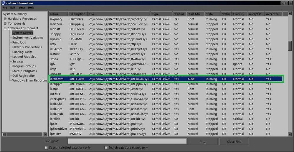

SergeyKostrov
Valued Contributor II
8,044 Views
[ Jonathan's log file ] ... Property(S): VT_Not_Support = This computer does not support Intel Virtualization Technology (VT-x). HAXM cannot be installed. Please refer to the Intel HAXM documentation for more information. Property(S): XD_Not_Support = This computer does not support Intel Execute Disable Bit (XD) or it is disable in the BIOS. HAXM cannot be installed. Please refer to the Intel HAXM documentation for more information. ... Jonathan, I did a quick check of your log file and could you verify on ark.intel.com web site that your CPU also supports Execute Disable feature?

SergeyKostrov
8,044 Views
Hi Tao, >>...I will try to install HAXM on a system with Intel Core i7-3840QM. The CPU supports many Intel technologies ( 3rd Generation! ) >>and let's see what happens. Successfully installed HAXM driver and it is working. I'll provide some technical details later ( log and screenshots ). By the way, I didn't do anything special...

SergeyKostrov
8,043 Views
Tao, Please take a look at attached files. Best regards, Sergey
SergeyKostrov
8,043 Views
Tao, I also used MsInfo32.exe utility to verify that HAXM driver is loaded and working: intelhaxmdriverstatus.jpg
