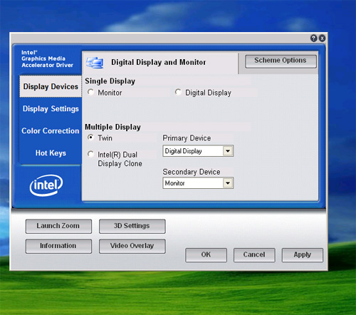

thanks, I have the 945G. Any thoughts on how can I get this fixed or what to install/reinstall? With 2 monitors hooked up I just don't have the 'extend desktop' option available to me.
attempting to show a screen shot here:

ok let me try again, image is at url below:
http://www.pac-king.net/k48/no_extended_desktop.jpg

so in the device manager does it show two graphics devices or one?
this looks like what a GZ should show

oh one thing to try is use the os property page to set extended desktop
if you right click on the desktop and click properties then click on the settings tab you should see a couple of monitors click on the one on the right and try to turn it on with the check box and try to check the extend my desktop to this monitor option. the other thing to try is try to switch which monitor is the primary monitor around using the property page and see if you can then extend it

yeah that is usually how I'd do it but it doesn't recognize or show 2 monitors on the settings page.
here is a screenshot:
http://www.pac-king.net/k48/settings_no_dual_monitors.jpg
Also tried switching which monitor was primary and going to properties and settings there but no go.
Manufacturer says it works with Vista and Vista drivers it just conflict with XP drivers and motherboard/onboard VGA.
Wish I could find another driver to try that might just work but I don't know where to start.

well I can't get XP to work with dual monitors and extend desktop with the 82945G Express Chipset but I can get Vista and Beta 7 to work. The only trick was I couldn't use the latest driver for 82945G I had to go one back. So I'm real happy now that 2 monitors are back, a bit bummed that I can't use XP but I need to move on to another OS sometime :)
