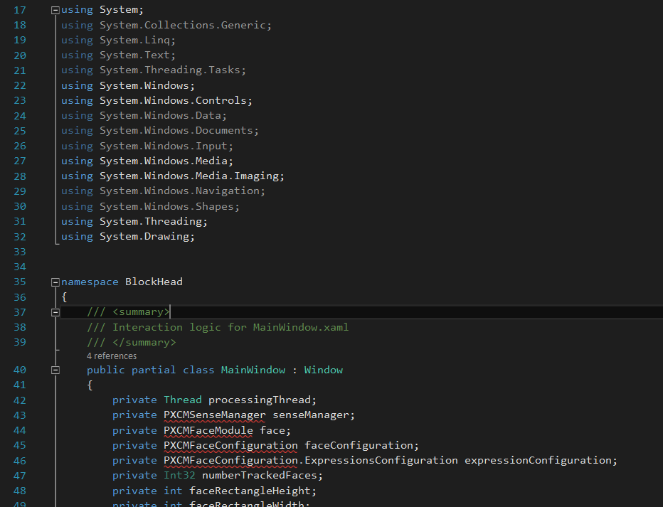

The problem is that I can't find any files in there that works with visual studios "Add Reference".
VS can't find the PXCMSenseManager(Image 2).
How or what should I reference so the SenseManager can be found?

You can find it under C:\Program Files (x86)\Intel\RSSDK\bin\win32 not C:\Program Files (x86)\Common Files\Intel\RSSDK\v6\bin\win32. Thanks!
After installing the SDK the folder you are referring to doesn't contain a RSSDK-folder, see attached image.
I don't get the option to choose where the SDK get's installed during the installation, so I guess it defaults to somewhere else?
I have installed the newest version before this, does it linger and block the installation after uninstalling?
Thanks!
Please uninstall any RealSense SDK, reboot and install the version you want.
