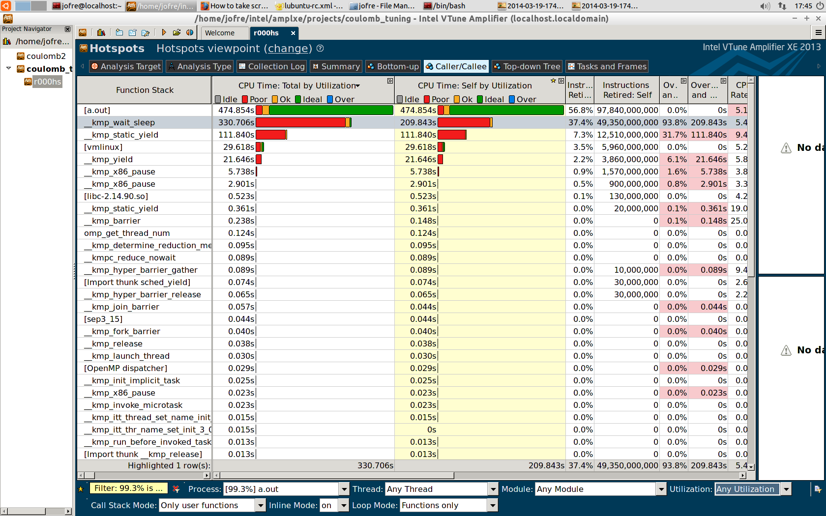

I have attached some screen-shots of the results of the Vtune. They represent good and bad news: bad news because I thought I had a highly optimized code (naive I know), good news because this means that there is, potentially, a lot of speed up to obtain!
However, a bit of insight of how to change the red into green would be welcome...
All the best, Jofre

I found an explanation to the problem of the high kmp_wait_sleep (just by chance!):
In theory in native mode I have access to the 60 cores, so 240 threads. For some reason, when running the tests from Vtune, there seem to be only 239 threads and not 240. As I had setup the code and the environment variables for 240 threads there was a huge kmp_wait_sleep. I obtained best results by changing the number of threads to 236 in the code and the environment to 59c,4t. and the kmp_wait_sleep time was reduced from 2762.8s to 323.7s (see the two screenshots of Vtune comming from the "hotspots" tests). I must say that I was calling the parallelized subroutine 1001 times.
I found in the web (http://crd.lbl.gov/assets/pubs_presos/ovsub.pdf) that OpenMP has a default waiting time of 200ms delay after each parallel section. Apparantly this waiting time can be changed (in the intel version at least) by the environment variable KMP_BLOCKTIME. I tried
export KMP_BLOCKTIME=1000
to increase and see an effect, but I did not see any appreciable difference. I must assume that I not changing the parameter, pity.
In a different register, if I run the "general exploration" test, I see that the L1 Hit Ratio is not very good.
Also, I am calculating correctly (Instruction Retired / CPU Time) I am far from the theoretical 1TFlop/s
Data collected before solving the wait_sleep issue (see above): (it should not affect the L1 Hit Ratio and Misses):
Particle L1 Hit Ratio L1 misses a_coulomb kmp_wait_sleep kmp_static_yield GFlop/s
240*2 1 0 18.719s 22.15s 11.55s 61
240*4 0.993 105,000,000 60.188s 75.34s 40.44s 164
240*8 0.960 1,288,000,000 210.084s 201.49s 108.28s 181
240*40 0.954 27,629,700,000 5816.408s 2822.69s 1461.03s 177
So, that seems like a bottleneck: if I want to have many particles per thread then L1 misses kicks in, in the other hand, if I have few ions per thread, then wait_sleep time becomes dominant!
I need to think a way out of this...

VTune on MIC does have the effect of tieing up one core; as most Intel developers have used 61-core platforms, the implications may be evident. If you want to use all 60 cores, VTune will distort performance.
I might expect better performance if you replace 1/dsqrt(x)**3 by 1/x/sqrt(x), unless the compiler is smarter than it used to be.
The 200ms default block time (resettable by environment variable) is shared by libgomp (which I don't think is available for MIC), but there isn't a satisfactory portable way to use environment variables to control it.
L2 misses would usually be more important than L1 misses, but with such high L1 hit rates it doesn't appear that you have a problem with cache.
KMP_BLOCKTIME should normally not be relevant on Xeon Phi, since what it does is determine how long a thread spins actively before suspending itself in the kernel. On Xeon Phi you should already be avoiding over-subscription, so it should make little difference to the performance whether a thread is spinning (with "pause" equivalents) or waiting in the kernel, since there ought to be no other threads to run on that core anyway.
So, setting KMP_BLOCKTIME=infinite ought to be fine, and seeing no effect from changing it doesn't mean that you failed to change it. (You can, of course, set KMP_SETTINGS=1 to check that you really did change it).

It is true that the following indicators from Vtune do not seem ideal:
CPI rate 5.325
Vectorization Intensity 6.181
L1 Compute to Data Access Ratio 11.083
L2 Compute to Data Access Ratio 267.297
But my knowledge does not allow me here to progress, what I do with the above information, where I should be looking? Can anybody tell me which type of test I could do to narrow source of the problem?
Jofre
Yes, you will need to verify that the big loops are vectorized outside the ones with sum(rji(1:3)**2). If not, you may need !dir$ simd or to replace sum with rji(1)**2 + rji(2)**2 + rji(3)**2 (or both?).
If important loops aren't vectorized, it's too early to worry about those cache ratios. Vectorization could improve or worsen them.
