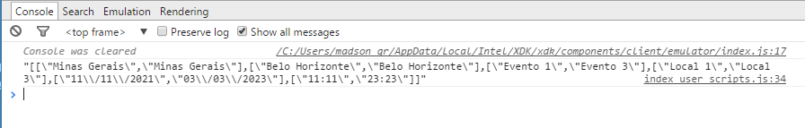

How do I populate my ionic list with thumbnail dynamically? The code below brings me the data from my db successfully but I am having some issues appending each value to each list item. item.nome and item.dia shows me "undefined" values;

Hi, Please add this line console.log(JSON.stringify(data)) below success: function(data) { And post the resulting string here. I think there is a easier way than the one you are using, but depends on the data structure. Regards Diego

do you mean this? I am very new to xdk

Yes, please do the same after
var data = $.parseJSON(data);
add this
console.log(JSON.stringify(data));
Diego

First and second results

Please check my edited question with php file too

Ok, I solved it fixing php according to http://diegocavalca.com/parte-4-construindo-a-api-para-integracao-de-dados/
Thanks for your time.
