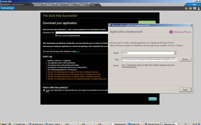

I've built a very simple start App - and having trouble deploying to the phone.
The Build works fine ...see here ...have the Windows Phone publisher in the settings
My Phone is Unlocked (using the Register tool) - and shows up in my developer account as being registered ....
But when I try to deploy I get the following?
See in Project build - the GUID it refers to I presume is my publisher ID which is there

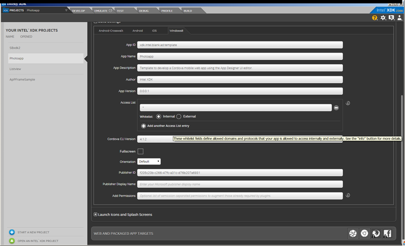

You have two publishers IDs: one for Windows and one for Windows Phone. The one that starts with a CN= is your Windows ID (but you need to remove the CN= before you use it for a build). Try both, one should work.

I can't access that link, you need to attach the build log.
According to the build summary you are still including the "CN=" prefix. Please remove that prefix, you should only be putting the GUID in that field in the XDK.

The CN is definitely not in the Project entry - must be getting added during the Build - see here....these from the demo PhotoApp
Also attached the Build log as a text file

The build engineer is working on the issue. Not sure how long it will take to resolve it.
