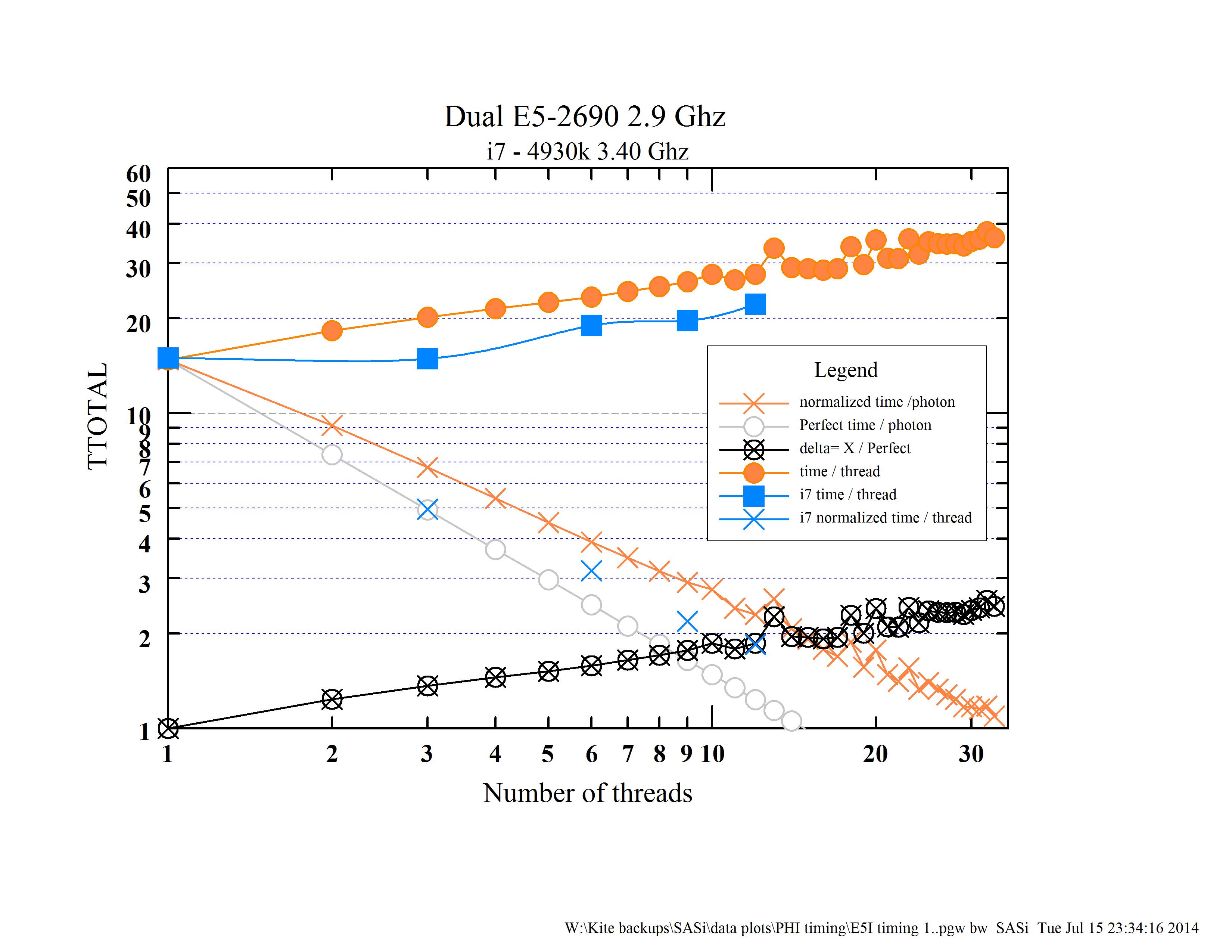

I'm trying to move a Monte-Carlo Fortran program using OpenMP from Xeons to the PHI.  The program scales very well on Xeons but very badly on the PHI.  I've attached some plots to quantify our results.  The program is not huge but the data that the threads access -- only as reads -- are several GBytes.  The data are mostly contained in two arrays which are not accessed sequentially while the code is running.  The plots are all normalized to the same time for one thread as the focus is on the shapes of the curves, not the absolute values.
The plot "Intel Comparison plot a" summarizes the results for two Xeon computers (dual E5 w/ 32 threads & an I7 w/ 12 threads) and the PHI.  The PHI is much slower than the Xeons.  It starts off 20x slower for the first thread, which is not so bad but gets much worse quite rapidly.  The two types of Xeons show little sign of fading, even with all the threads available on the I7 & E5 and the fact that the code is very (80%) back-end bound.  The code was designed to be quite scalable (although not very vectorizable).  This is shown in more detail in the E5I timing plot.  The grey line shows perfect scaling and the Xeons show no sign of flattening out with the number of threads.  The bumps at 13, 18 threads, and the few in  the mid 20s are real, not statistical fluctuations. Don't understand those.  Interestingly, the I7 is faster than the E5.
However, as shown in more detail in the "PHI timing 1" plot, at about 8 threads, the PHI results get quite flat and stay so until somewhere over 100 threads when they pick up steam again.  In the end, the PHI ends up being about 100x slower than would be a Xeon with the same number of threads and using all the PHI threads is 4 - 5x slower than the 32-thread E5 setup.  These results are pretty much the same no matter how we set the affinity (doesn't matter anyway, I think, as we want to run with all threads).
Our only thought so far is that there is something about the ring bus that is hosing up the access to the large arrays.  We have not been able to think of a way to get around this or to decide exactly what is causing the problem way before we even get to one thread per core.  We expected to get good scaling at least until we got to 56 threads.  Any thoughts on this would be greatly appreciated.

A 20:1 performance ratio between a single thread on a Xeon E5-2690 and a single thread on a Xeon Phi is quite unusual -- there are only a few attributes of the systems that show such large ratios.
Since you note that the memory accesses are not sequential, the first place to look is the memory hierarchy.
One ratio that is in this range is the random latency to arrays that fit in the 20MiB L3 cache on the Xeon E5-2690 but don't fit in the 512 KiB L2 cache on the Xeon Phi.  I typically measure about 35 ns L3 latency on the Xeon E5 (Sandy Bridge) systems, which is in the 9-12 ns range (depending on the Turbo boost frequency), while L2 miss latency (i.e., to DRAM) is about 275 ns on the Xeon Phi.  My measurements are on Xeon Phi SE10P systems, but other models should be close.   This gives a 23x to 30x advantage to the Xeon E5.     L3 cache latency on the Core i7-4930k is probably a few cycles less than on the Xeon E5-2690, which combined with the higher frequency could account for the ~23% performance advantage of the Core i7-4930k on 6 cores (as I interpret the data in figure "E5I timing 1.jpg").
Could this performance ratio could be appropriate even if the total size of the input data is much larger than the L3 cache?   Yes, I think so.  There are very significant differences between the L2 hardware prefetch engines on the Xeon E5/Core i7 and the L2 hardware prefetch engine on the Xeon Phi.  I discuss some of the attributes of the Xeon Phi prefetcher in the forum thread at: https://software.intel.com/en-us/forums/topic/517716, but it appears to be a simple prefetcher that can only detect strides of 1 or 2 cache lines (on up to 16 different 4KiB pages).
I don't think that the L2 prefetchers on the Xeon E5 and Core i7 have been fully described, but from my experiments it appears that they will treat *any* two accesses into a 4KiB page as defining a "stream", and will immediately prefetch up to two cache lines along the (assumed) stride (provided that the computed addresses to be prefetched remain in the initial 4KiB page).  Despite its name, the "L2 prefetcher" does not automatically prefetch into the L2 cache.  It does automatically prefetch into the L3 cache, and sometimes also prefetches into the L2 cache, depending on how many outstanding demand loads are in flight, how many L2 misses are in flight, and other factors that are alluded to vaguely, rather than actually documented.  This L2 hardware prefetch behavior is *extremely* aggressive, and makes it very difficult to load more than a few items per 4 KiB page without having many of them automatically prefetched.   So if the "non-sequential" access pattern has enough locality to have multiple accesses before overflowing the stream tracker (which can track up to 32 streams of data accesses), but not enough locality to activate the much more primitive hardware prefetcher on the Xeon Phi, then much of the data will end up in the L3 cache on the Xeon E5 and Core i7, making the L3 latency vs memory latency comparison appropriate.
A few experiments with Intel's VTune (or with other performance monitoring tools) should be able to show whether this hypothesis makes any sense.  If I am correct, then the code will show a high L3 load hit rate on the Xeon E5 and Core i7 and a high L2 load miss rate on the Xeon Phi.

Hi John,
This makes a certain amount of sense as, on a per thread basis, the access to the two large arrays is somewhat locally random but not globally.  That is, while the whole data array is Gbytes, a thread is progressing through it with a window of about a hundred or so KBytes.  However, the thread's windows slowly drift apart.

False sharing:  we did worry about false sharing since all the threads write their results to a single, relatively modest size [100KB] array,  However, if we run the code w/o that line of code, we see no improvement in times.
John: I interpret what you're saying that finding data in the ring buffer is as expensive as going to memory.  I guess we don't know how long it takes to find out it isn't in the buffer (cache to cache transfer candidate) and then go to memory.  If this is large and our main data array is large compared to the buffer, that becomes a fixed cost, on average, to a simple memory access.  humph!

A large fraction of the average memory latency is due to hopping from the core to the DTD to the memory controller, etc, but this is the way the chip works -- there is no provision for a "bypass" path going straight to memory (which would be a variable distance anyway, since the 8 memory controllers are distributed around the ring).   A core would not even know which memory controller to ask for the data, since it works with contiguous physical addresses and these don't need to be converted to the non-contiguous addresses needed to access memory until after the DTD has determined that none of the caches has a copy of the cache line in question.
Much of the transaction path for cache-to-cache interventions and memory accesses is the same, and the parts at the end that differ end up having average latency that is dominated by hops on the ring and slight differences in required transactions, so DRAM latency ends up being a negligible portion of the total load-to-use latency.  GDDR5 DRAM latency for an open-page read is ~12 ns, which is less than 5% of the total latency.
Bruce_Weaver
13,064 Views
So, in my case with an array that is much larger than the ring bus, memory access is going to be significantly slower than just going to memory?  And it is part of the fundamental hardware design and there is no way around this issue?

I had expected about a 2x improvement compared to a pair of fast E5s.  This was worthwhile as the code takes E5 thread-days to  -weeks to run.  Only this modest amount because the code does not lend itself to vectorization.  We find that for small test programs, the PHI performs more or less as expected.
Still, I'm most confused about the change in performance slope of the PHI after about 100 threads where it starts to get better again.  As you can see on the PHI timing graph, the time/photon -- the basic measure of performance for this code -- and even the time/thread starts to improve.  In fact, the slope becomes better than 'perfect'.  Those curves are from scattered or balanced affinity-- they seem to produce the similar results.  We have yet to try compact, which, if caching is to help rather than hinder, may show some improvement.
