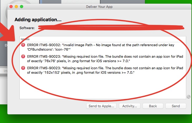

Submitting an app iOS with Application Loader got error missing icons... see attached shot ...
what to do? first time tried do submit... i put all iOS icons in xdk app settings... well

Did you use PNG images? JPG images will not work. Did you build with CLI 4.1.2 or CLI 5.1.1?
Alternatively, you can add the icons using the intelxdk.config.additions.xml file. See this FAQ entry and this example set of iOS icons (below). In this example set, the pkg directory is inside your www directory:

Leonidas_S_
11,981 Views
used
CLI 4.1.2
png used
res/ios/...
the xml file above is in www/   ...?

Leonidas_S_
11,981 Views
same error getting with PNG icons in Application Loader
intelxdk.config.additions.xml  try use this???
well?
Leonidas_S_
11,981 Views
same EXACTLY error getting as in  2015-12-07 21-13-20 error xdk app loader.jpg  thread #1
I INSERTED THIS >>> IN intelxdk.config.additions.xml THAT I ADDED - NEEDED REFER IT ANYWHERE OR IS FOUND AUTO????

<intelxdk:crosswalk xwalk-command-line="--ignore-gpu-blacklist" />
PaulF_IntelCorp
11,981 Views
Leonidas, sorry, but I'm having trouble helping you and understanding your questions. It would work better if you posted detailed questions in your native language and let me translate those detailed questions. Your English is very hard to understand, it would be better if you posted detailed questions in your native language.
Leonidas_S_
11,814 Views
I giveup my native now only English and second Russian.
Basically tried create www folder, rebuild in xdk , same error in application loader, exactly same error.
Samely created the intelxdk.config.additions.xml above, rebuild, again Nothing changed in error... in application loader...
Error is the atrached as in initial/started post #1 - in this thread sequence... in this page in other words...
Am I clear...
