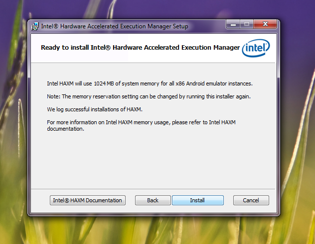

Unable to install HAXM, VT active in bios, CrystalCPUID attached
Shivam_K_
3,209 Views
I have tried installing Intel HAXM in my system but was unable to do that as it says VT-x not enabled but when i looked in bios it is enabled. My processor is intel core2 quad q9550 with windows 7 professional installed.

I tried to install HAXM in my Laptop and tells me the same error (Annex printscreen) I need to install to use the Android Debug Studio I have Avast but I try to install the HAXM having it off and nothing. I Try performing the procedure outlined in the forum and continued with the same error could help me? I urge install it for my thesis project, Thank you for your attention

After trying everything, I tried resetting bios to factory settings, thus disabling the VT-X , but somehow my windows crashed and had to reinstall it. After that tried enabling the Vt-X and installing the HAXM, finally succeeding this time.
In short, i was able to install it but i don't know who did the trick , resetting bios and again enabling it or reinstalling the OS.
So, I hope you must gve a try to resetting the bios to default options and then enabling it again, if all fail and still you wish to install the same, you may try reinstalling the OS (i hope somewhere my os was not allowing the same).
Regards.
