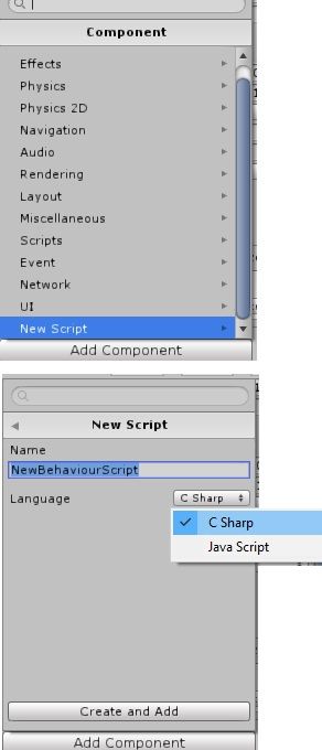

With the sphere successfully created, tested for horizontal rotation and tagged, we can now begin constructing the scripting that will read the rotational angle of the sphere in real-time and freeze rotation if the real-world head is turned to the left or right of the front-center orientation.
Highlight the sphere and create a new C# format script file inside it.  This can be done by highlighting the sphere and then going to the 'Component' menu of Unity and selecting the 'Add' option to open a pop-up window of options.  You should select the 'New Script' option from the bottom of that list, select 'CSharp' as the script type from the drop-down menu and provide a name for your new script.
For my own project's script, I chose the name 'HeadRotator_LeftRightTurn_Freeze'.  It is a good idea to give your script a name that describes what it does so that you can quickly find it again by searching for keywords such as 'freeze'.
