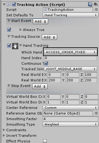

I would like to ask you how to accurately distinguish right hand, I have one for eachfinger joint added TrackingAction, and choose about, but he is very unstable, and thishow to solve it. Thank you
MartyG
5,061 Views
Yes, the camera sometimes has more difficulty dealing with two handed control than it does with one-handed control.  This is because the left and right hands fight about which one should be active.  So if one hand is nearer to the camera than the other, the object that is controlled by the nearest hand is moved whilst the object controlled by the other hand stops moving, because the tracking of that hand's movement stops.
There are some ways in which you can make two handed control more stable though.
1.
On the objects that use a TrackingAction with an Index value of 0, place a tick mark in the Continuous box.  This box makes tracking of the Index 0 objects more stable, because it tells the camera to focus on tracking the Index 0 hand even if the Index 1 hand appears in the camera's view.  Movement of the Index 0 hand will therefore not stall because of the camera getting confused about whether Index 0 or Index 1 should be active.
You should not though tick the Continuous box in the TrackingActions that use Index 1.  This is because if you do this, the Index 1 object tends to ignore what the Index 1 hand (the second hand) is doing and instead follows the movements of the Index 0 hand.  This causes Index 1 objects to exactly copy the movement of Index 0 objects instead of having their own independent movement.
An example of this in my full body avatar is that if the right arm is lifted up, the other arm lifts up too so that both arms are raised in the air, even though it was only meant that one arm should be raised.
2.
I also recommend setting the Which Hand option to the "Access Order Fixed" option for better two-handed control, as shown in the image above.  This should help to make sure that Index 0 objects are controlled only by Index 0 and Index 1 objects are controlled only by Index 1.
If you use the default option, "Access Order Near To Far", then the camera will try to make the hand that is nearest to it the active one instead of both hands being active at the same time.
3.
Another way in which you can make two handed control more stable is to set the Start Event of the Index 0 TrackingActions to 'Always True' and set the Index 1 TrackingActions to have a Start Event of 'Two Hands Detected'.  This makes the camera less likely to get confused about which hand should be active.
The reason  for this is that if Index 1 (the second hand) is set to Two Hands Detected, the camera knows that it is impossible for the second hand to be active unless both hands are visible.  It will therefore control the Index 0 objects with either the left or right hand until it sees the second hand appear.  It will then control Index 0 objects with one hand and Index 1 objects with the other hand.
When the second hand is no longer visible to the camera then it will regard the Two Hands Detected condition to be "lost" and revert to moving only the Index 0 objects until the second hand is visible again.
When Two Hands Detected is used, the camera also seems to be more forgiving of one hand being behind the other and is less likely to lose tracking and stall the movement of the Index 1 objects.
4.
Yet another technique for effective two handed control is what I call Air Drumming.  When the camera loses tracking of an object, it takes a few seconds before Unity catches up with the loss and stops moving the object.  You can therefore maintain continuous tracking of both hands by "drumming the air" as you move your hands.
What I mean by this is that you move your hands forwards and backwards in the air, so that the right hand is in front of the left hand, then the left hand is in front of the right, and then the right is in front again.  By doing this, you are continuously swapping which hand is the active one, and so movement does not stall: because of the time delay of a few seconds that it takes before Unity stops moving an object, the drumming is always re-activating tracking of a particular hand before it has time to stall.

Thank you very much for the TrackingAction images. That helps me a lot.  Your settings are almost correct.  However, you should do two more things:
1.  Remove the 'Hand Lost' setting from the Stop section of both hands.  You do not need it, as movement of the hands will stop anyway when your real life hands go outside of the camera's view.
2.  I think the main problem is that you are using the settings 'Left Hand' and 'Right Hand' for the Which Hand setting.  If you use this arrangement with a two-handed avatar then one hand can indeed affect the other.  I tested this with my own avatar and confirmed that this is still the case.
What you should do is change both hands to 'Access Order Fixed'.  Also make this change for your avatar's arm joints if they are able to move with TrackingActions.
You will notice that in my Real World Box settings, I am using different values from yours (100 for Center and 200, 200, 200).  You do not need to copy this into your own TrackingActions if you do not want to.  This is an experimental system I am using, as I found that the arm movement seems to stall a lot less if you double the default values to - I guess - double the width of how far the camera will let you move your hands away from its centre before tracking is lost.
You will also see that I am using values of '1, 1, 1' for my Virtual World Box.  Again, this is my personal preference and you do not have to use it yourself.  I just find that with a value of '1', the arm does not spring backward behind the avatar when the hand is detected.  Your arms may work just fine with the '0.1' setting you are using.
If you have changed the Which Hand setting to 'Fixed ID' and the hands are still not moving right, I would check the object child link hierarchy of your arms.  The linkage of the two arms should be totally separate.  If you have accidentally linked a part of one arm to a part of another arm then when one arm moves, it will make the other arm move with it.  It is an easy mistake to make and I have done it myself a number of times.

Let us take it one step at a time.  First, please try changing your 'Access Order Left Hand' and 'Access Order Right Hand' settings so that both TrackingActions say 'Access Order Fixed''.
讓我們把它一步一步的時間。首先,請嘗試更改您的'AccessOrderLeftHand'和'AccessOrderRightHand“設置,以便TrackingActions說'訪問順序固定'。
