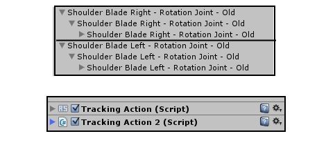

I began using two-TrackingAction arrangements in the arm and hand joints of my RealSense-controlled avatar to gather some data about how they behaved in comparison to the old approach of having a series of child-linked joints, each with one TrackingAction per joint in it.  Here are my findings.
(a) If you have been using multiple linked joints to provide an object with more than one direction of movement (e,g moving the avatar's hand left / right with one joint and up / down with the other) then the hand behaves exactly the same when a single hand joint with a left-right 'TrackingAction' and an up-down 'TrackingAction2' is used.  So this an area where using a two-TrackingAction object can simplify the design of a system.
(b) If you have been using multiple linked joints to amplify the motion generated by a facial part that normally does not produce much movement in an object (e.g the left lip side) then putting two TrackingActions into a single joint instead of having two linked pieces with one TrackingAction each inside them does not produce an amplification in motion.  So the multi-TrackingAction system is not so useful for amplifying object movement when using only one joint.
However, we did find during testing that if you are using two linked TrackingAction-powered joints to produce an accelerated movement, then having two TrackingActions in each of these joints gives you the motion amplification, *and* amplifies the movement distance by x4 instead of x2.
Edit: just in case anyone at Intel reads this: a very simple way to implement multi-Action script support in a future SDK would be simply to package several pre-made copies of an Action script that were named, for example 'TrackingAction', 'TrackingAction2', 'TrackingAction3', etc (i.e have a folder for each Action script instead of having all the scripts in one folder like it is now).  Then developers can quickly build very versatile applications without having to resort to the long process above involving a word processor and Find n Replace.
MartyG
2,363 Views
Here's a video of our latest use of the 'multiple TrackingActions inside one object' technique, where we showcase a version of our avatar arm's shoulder side-swing that is much easier to use than the previous version (in the old version the swing-across only worked when the arm was lifted to a certain height).
https://www.youtube.com/watch?v=JRFpQGL-cYM&feature=em-upload_owner
In this setup, we have three child-linked spherical joints in our left and right shoulders that move the shoulder-blade flesh object and everything beneath it down to the fingers at the base of the arm.
Each of these three joints has two individually numbered TrackingAction scripts in them - see the very top of this forum post for a guide to how to make multiple TrackingActions.  We created alternate copies of the TrackingAction because if you put more than one copy of the original TrackingAction inside the same object, the camera only listens to the first one in the list and ignores the settings of the rest.
The pair of TrackingAction scripts in each of the first two of the three joints have identical settings.  They are constrained so that only the 'X' rotation axis is unlocked, enabling the joint to rotate up and down on the spot to lift and drop the arm attached tot them.
The pair of 'TrackingActions' in the third and final joint, meanwhile, are constrained so that only the 'Y' rotation axis is unlocked.  This enables the shoulder to rotate forwards and backwards at one end, so that the arm can more easily arc around to the front of the body.
Whilst you could achieve something similar just by having both the 'X' and 'Y' rotation axes unlocked in a TrackingAction in a single joint, the up / down and left / right rotation that you get from that method is less controllable than if you divide the up / down and left / right functions between separate rotational joints.  By doing it this way, you can also apply different settings to each movement direction.
