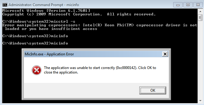

Hi All,
I have the same problem as Yuan. When i try launching micinfo (per loc-nguyen's suggestion), I get an error message saying 'The application was not able to start correctly (0xc0000142). Click OK to close the application.'
Any advise on how to troubleshoot the problem with driver installation?
I am running Windows 7 Enterprise SP1 64 bit with Intel MPSS 3.1 for Windows. I see the Intel Xeon Phi Coprocessor Reliable Availability Service (which also fails to start, btw) in the SCM list, but nothing else.
Thank you for your help in advance.

I managed to resolve the issue. In my case the problem was caused by improper card installation (one of the power connectors to the card was effectively not connected). After fixing the hardware part, the co-processor was recognized by the host, and everything worked as expected.

Dear all,
In the step 2.2.3 Update the flash, I had the same message: "Error manipulating coprocessor: Intel(R) Xeon Phi(TM) coprocessor driver is not loaded or you have insufficient access". The cause is the two power connectors of the card must be connected ! Thanks Vlad for the tip.
There is a second possibility about hardware installation: the PCI slot must be enabled. I work with a numa machine designed to host a pair of xeon processors. As there is only one xeon processor installed on the motherboard, 3 slots are automatically disabled. When the coprocessor is placed in a disabled slot, the error message above is displayed. The solution ? Install the coprocessor on one of the 4 enabled slots, the xeon phi card will be detected and the driver will run fine.

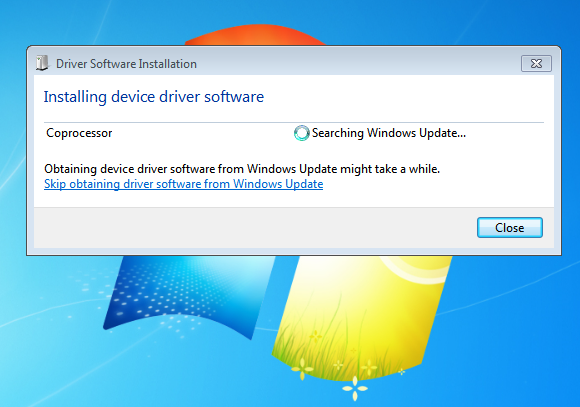

I ran into same problems after some time of the initial problems. I initially did not see my card even on BIOS but I switched the PCI slot as suggested and it came up on BIOS, and after that Windows 7 Professional saw that there was a coprocessor card as well:

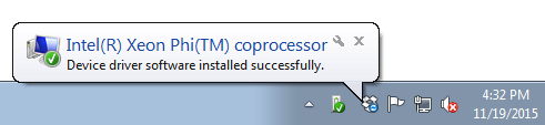

And after the MPSS 3.6 installation the card was found:
However I got the same errors when trying micctrl -s and micinfo, and I had rebooted after the MPSS 3.6 installation as well.
